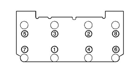

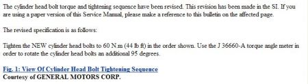

The pontiac repair manual says head bolt's to be torqued to 44 ft/lbs. plus 95deg. But Fel-Pro, the maker of the replacement head bolts instructions included in the box of bolts says 33 ft./lbs. plus 90deg. I double checked to make sure that they were all in ft./lbs and they are. Which one should I go with?

Hi there, Mitchel 1 specs on Head bolt torque and sequence . I would go with the 44 Ft/ib & 95 Deg. mark (mhpautos)
