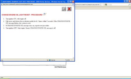

how to reseat engine oil light
Sep 16, 2010 at 5:03 PM
SATURNTECH9
  • 30,869 POSTS
https://images.2carpros.com/forum/automotive_pictures/416332_2000_pontiac_montana_oil_light_reset_2.jpg
There you go.
