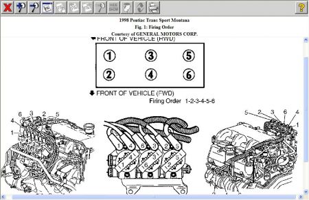

hello...
i need a firing order for my pontiac montana....we did a diagnostic test and all it said was random misfire.
so will that be the problem for my van?
it'll do slight jerks when accelerated and less power than usual...but engine turns with no problem.
Feb 22, 2009 at 6:24 AM
  • 75,988 POSTS
https://images.2carpros.com/forum/automotive_pictures/12900_fo_38.jpg
Jerking could be caused by the following Dirty fuel injectors (cleaning the injectors often fixes this). Bad MAP (manifold absolute pressure) sensor Bad TPS (throttle position) sensor Bad or dirty MAF (mass airflow) sensor Low fuel pressure (leaky fuel pressure regulator or weak fuel pump) Vacuum leaks (intake manifold, vacuum hoses, throttle body, EGR valve) Bad gasoline (fuel contaminated with water or too much alcohol) Sometimes, what feels like a hesitation is actually ignition misfire rather than lean misfire. The causes of ignition misfire may include: Dirty or worn spark plugs Bad plug wires Weak ignition coil Wet plug wires
