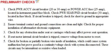

fuses are good switches are tight seat wont move

https://images.2carpros.com/forum/automotive_pictures/307763_Noname_14.jpg
