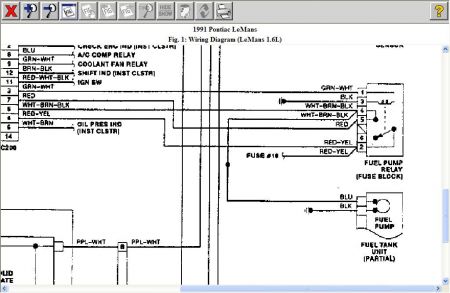

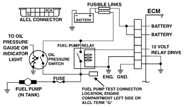

I have just purchased a new fuel pump for my pontiac, and some how i am not getting any electricity to it. Does anyone know where i can get a wiring diagram for the car or have any other suggestions?

Check the fuel pump relay and fuse. Note: All you got is 2secs to look for power before the relay cuts it out-The computer energizes the relay.
https://images.2carpros.com/forum/automotive_pictures/12900_oil_sending_unit_and_fuel_pump_circuit_65.gif
https://images.2carpros.com/forum/automotive_pictures/12900_fuel_pump_12.jpg
