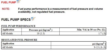

I have just changed my fuel pump and I have no repair manual. therefor I am uncertain what the fuel pressure should be.

https://images.2carpros.com/forum/automotive_pictures/261618_Noname_825.jpg
