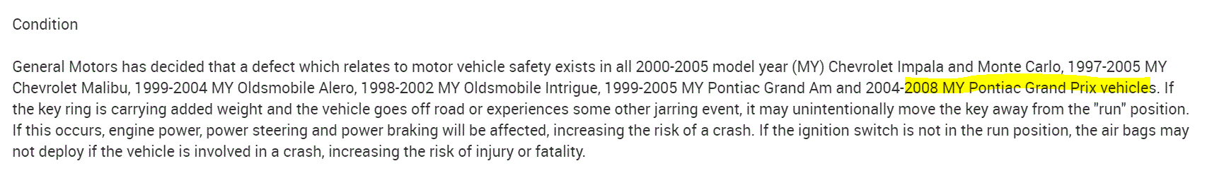

The car loses engine power and won’t go over 30 and sometimes would just turn off and now that i remember i was told by a mechanic that it was the ignition switch but i didn’t think it was i do also remember it turning off when i was at a stop light but i thought it was because of the bad battery and it also turn off while taking turns.

It could very possibly be related to the ignition switch. Have you had the switch replaced under a manufacturer recall?
Take a look at the attachment and let me know if this was taken care of.
See pic below.

no i have no changed the ignition switch since i bought it from someone else i don't know if the person i bought it from did and i don't have any way to contact them and asking. I'll fix it, I'll get back to you when i do. thank you for your help!

First, you are very welcome. The recall was the result of the ignition switch moving between run and off. It was somewhat dangerous. Here is what to do: Contact a GM dealership and ask how you can determine if the recall was taken care of with your vehicle. Since there are no longer Pontiac dealerships, try any Chevrolet, Buick, GMC, and so on dealers for help.
