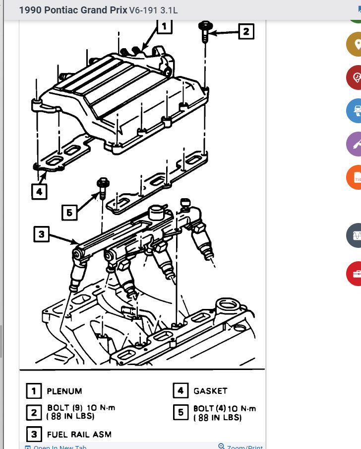

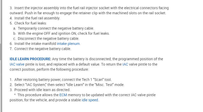

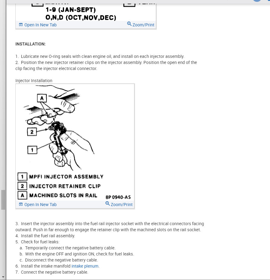

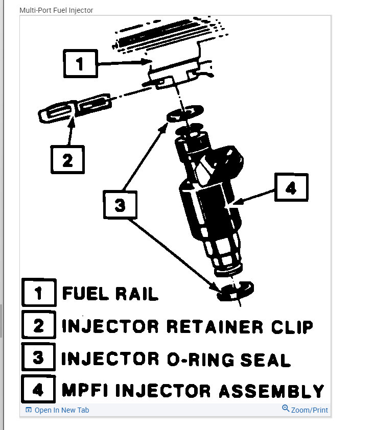

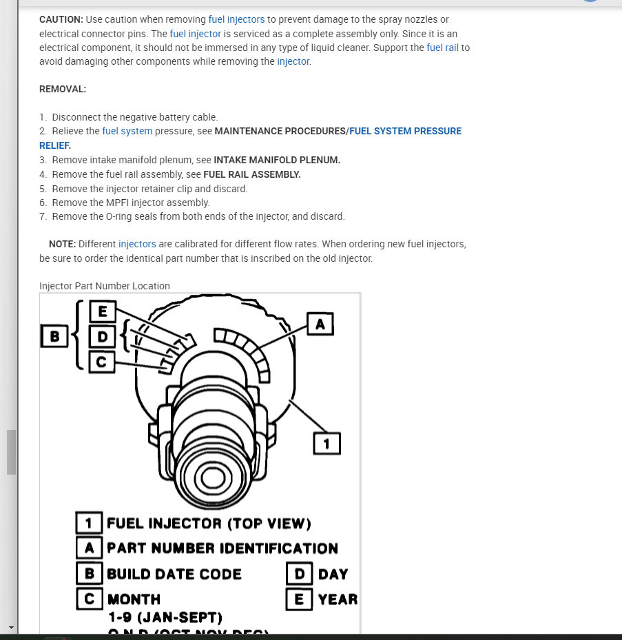

Just so that everyone has the info on how to do the same testing and find the issue if they have similar issues.
Here are some guides that will help with fuel pressure and injector testing.
Keep in mind we need to test the pressure and then watch how long it takes to drop.
It should hold the pressure for a while before it starts to bleed down.
https://www.2carpros.com/articles/how-to-test-a-fuel-injector
I attached the process as well for how to replace the injector.
Please run through this and let us know if there are other questions. Thanks
