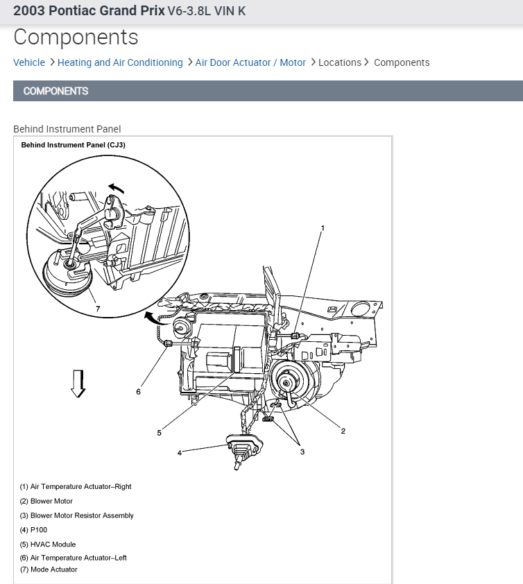

I have a 2003 grand prix which was recalled, and the dealer added some kind of pellets to the coolant. Now i have no heat and it feels like there is gravel in the heater hoses that run to the heater core. the pellets were added a couple of years ago. How do I flush the heater core?
Jan 13, 2007 at 9:06 AM
SQM
  • 6,383 POSTS

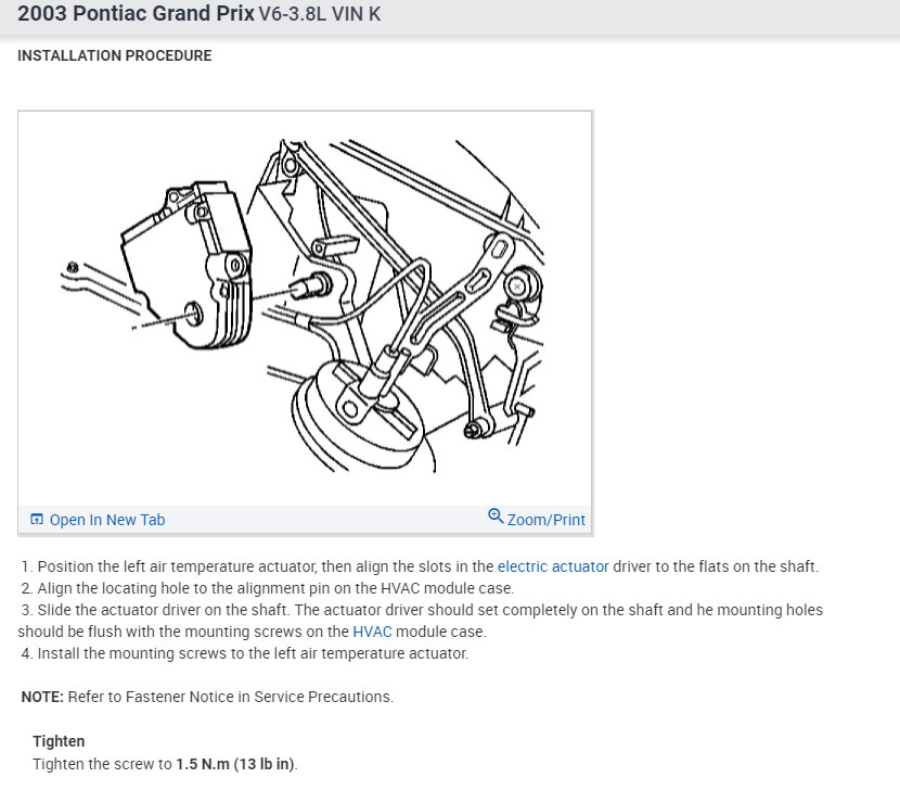

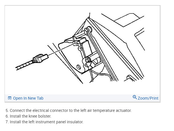

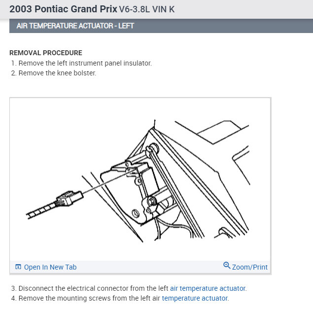

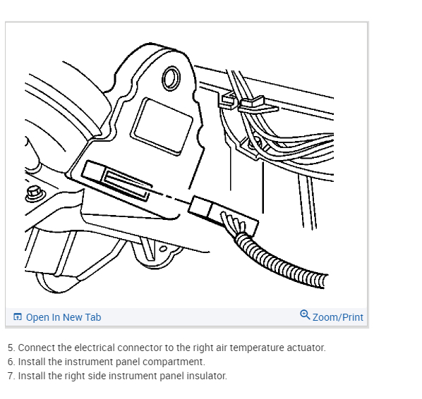

There are a few reasons why the heater might not work.
It could be due to low coolant, clog in the heater core, the engine not warming up properly, faulty blend door actuator.
Take a look at this helpful guide:
Here is a guide on how to flush the cooling system:
https://www.2carpros.com/articles/coolant-flush-and-refill-all-cars
Please take a look at these guides and let me know if you have any questions.
