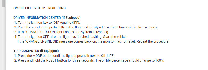

I just had the oil changed on a 2003 Pontiac Grand Prix. It has 78,000 miles on a 3.1 liter, 6 cyl. engine. My mechanic could'nt find the reset switch for the change oil soon warning light. Please help.
Jan 29, 2007 at 5:35 PM
That is not an uncommon thing with a lot of mechanics. Unfortunately they are all different in different vehicles. It is even different in vehicles from model year to model year so it is always best to check the manual.
Here is a guide that will help with this as well if you don't have a manual:
https://www.2carpros.com/articles/oil-life-reset
Below I attached the info from the manual on this specific vehicle. Please run through this material and let us know what you find with this. Thanks
