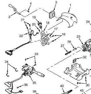

Working on a 2000 Grand Prix 3800 eng. Fairly sure the turn signal switch is bad because it runs through the T/S switch, right? Cruise is inop as well. Main problem is getting the horn pad/air bag module off. There are supposed to be 4 screws in back but can only locate two at this time. Anyone changed out this module? I am a tech myself, but out of the business about 3+ years now. Back problems will do it every time.
Thanks in advance for your help.

Back problems suck, been there...are there.
https://images.2carpros.com/forum/automotive_pictures/30961_prix_1.jpg
T/s switch sounds like what I would expect.

Well, he got it before I got down there. It was a b**** to get to those screws, but he got them out and changed the combo switch and that fixed it. That's something to remember on my GMC. It all runs through the Turn signal switch. Brake lights, T/S, cruise and wipers. Scary!
