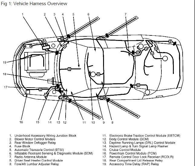

my high temp fan would not shut off. i pulled the fuse and it quit running. now something with the fans or heating system keeps drainging the battery. Think maybe it is a bad relay????? but don't know which and where is the right relay to test or if I am looking at the problem.

The fan relays are in the underhood fuse block. In the picture, #1 should be the fuse box. Hopefully the lid on the fuse box should tell you which relay is which. If not, then check your owners manual.
