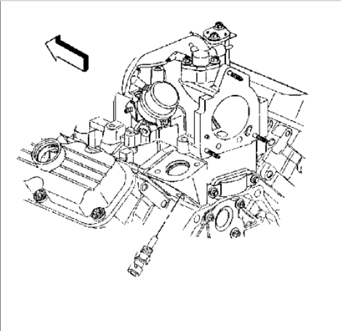

temperature gauge quit working. It still cycles on and off when you first crank the car. Then stays in the off position.
May 11, 2009 at 2:33 PM
  • 55,423 POSTS

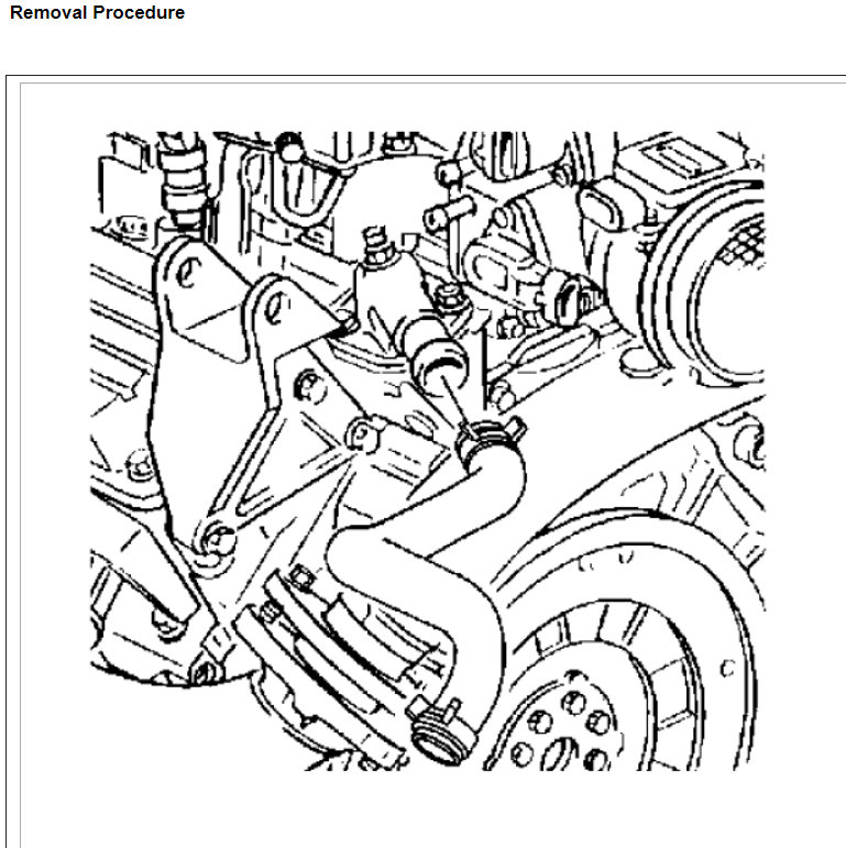

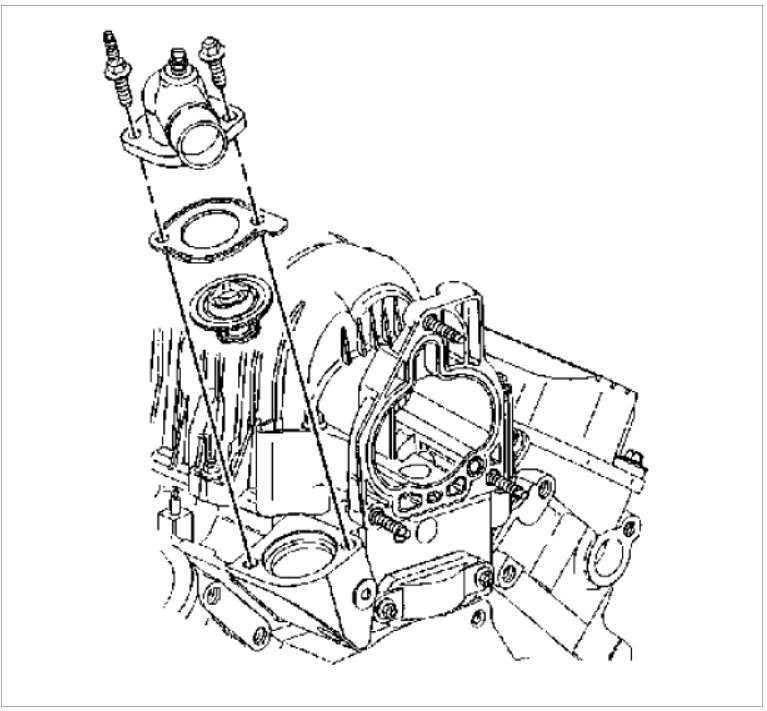

It sounds like one of two things maybe happening. Fist is the temperature gauge is working fine and it is a thermostat that is stuck open causing the engine to run cold or you have a temperature sensor that has gone out.
Here are guides to help us confirm the problem and get it fixed.
and
https://www.2carpros.com/articles/coolant-temperature-sensor-cts-replacement
Here are how the jobs are done on your car (below)

You may have air in the system or the heater core could be plugged up from Dexcool gone bad.
I would flush the whole system and install a new thermostat. Pull the hoses off the heater core and flush that in both directions thoroughly with a garden hose under pressure.
