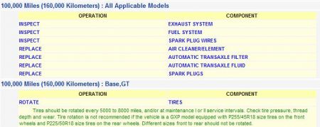

When should I get a tune up or change spark plugs?

For the mileage of your vehicle as right now, all you need is normal oil changes and tire rotation for the next 20,000 more miles. At 100,000 miles you need to perform the following:
https://images.2carpros.com/forum/automotive_pictures/261618_Noname_56.jpg
Hope this helps.. Thanks for using 2carpros.com!
