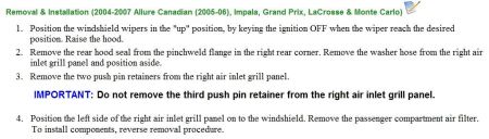

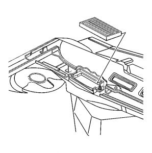

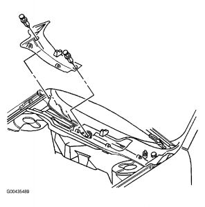

I need to replace my cabin air filter on my 06 Grand Prix. I do not know how to access the compartment that houses the filter or even where it is located. Can someone tell me where to find it or show me a picture of where it is located?
Jul 31, 2010 at 10:53 AM
BLUELIGHTNIN6
  • 16,542 POSTS
Hello and thanks for donating Follow steps below to find and replace cabin filter. .
