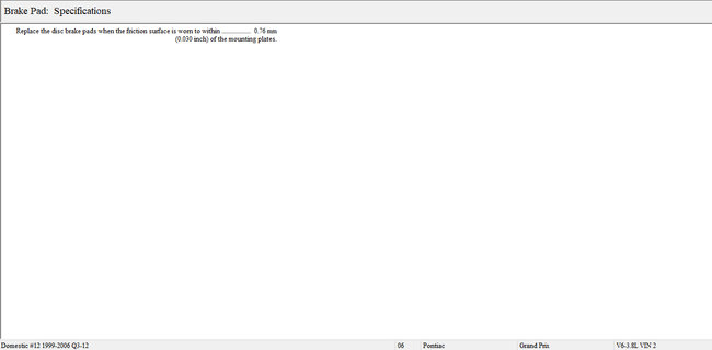

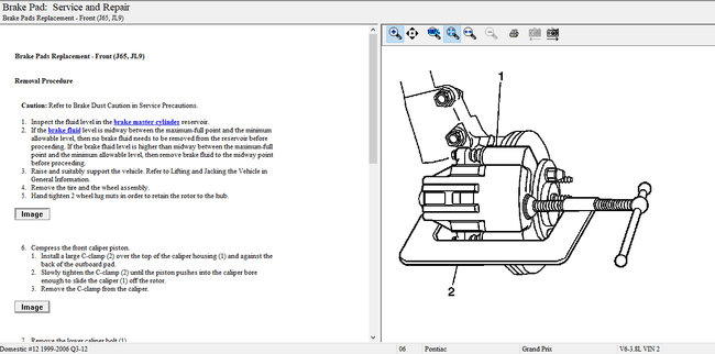

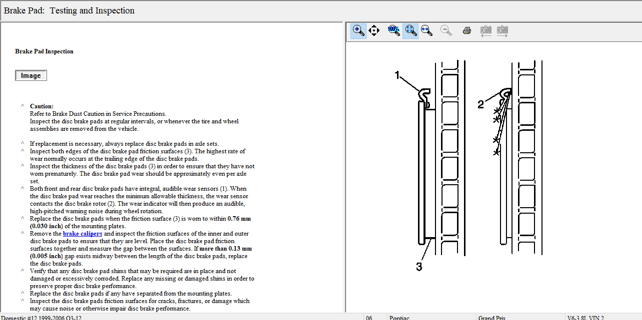

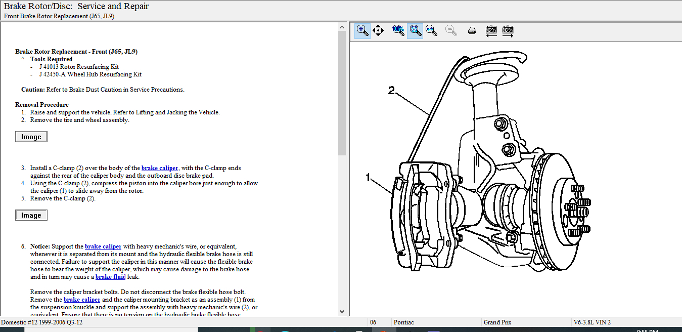

Ok, question. I have an 06 Grand Prix. And once in a while, I will hear squeaking when I hit the brakes Any ideas? suggestions??
Apr 3, 2009 at 11:34 AM
SEVAG P
  • CAR REPAIR CONTRIBUTOR
  • 405 POSTS
hello.

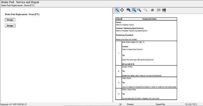

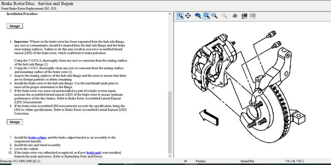

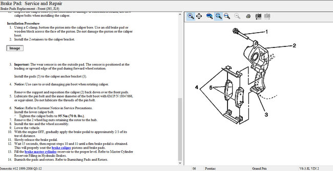

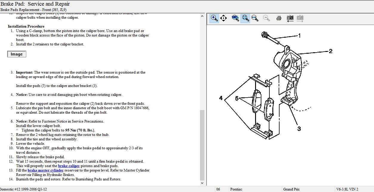

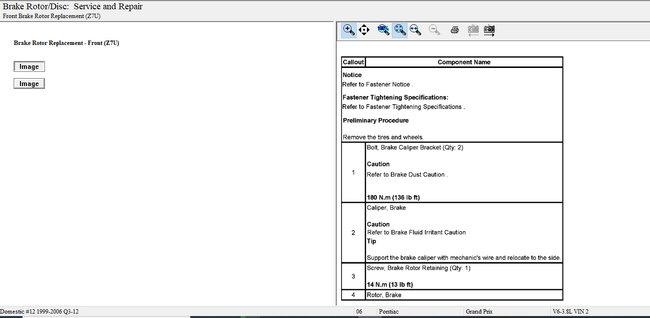

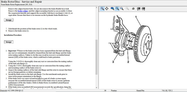

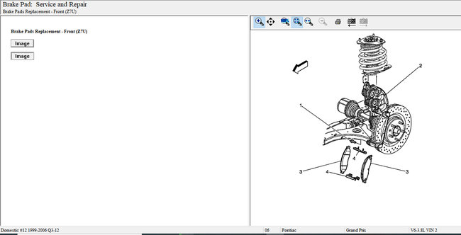

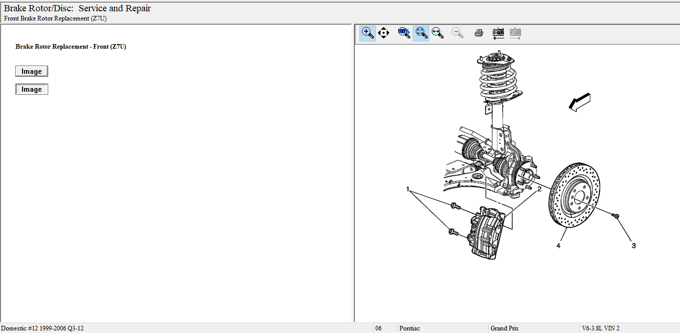

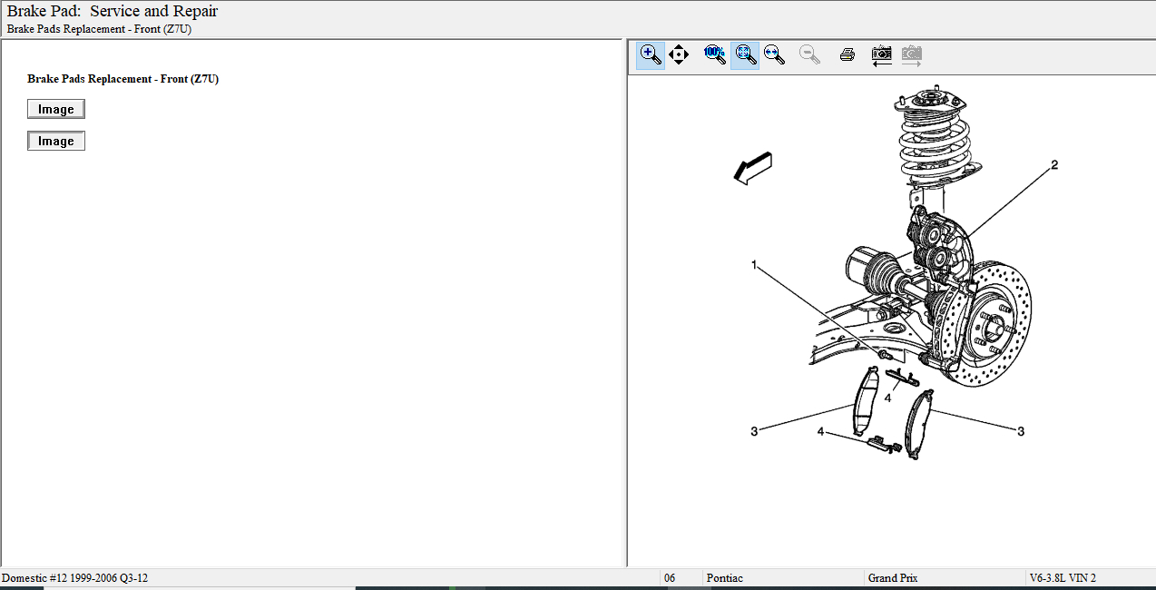

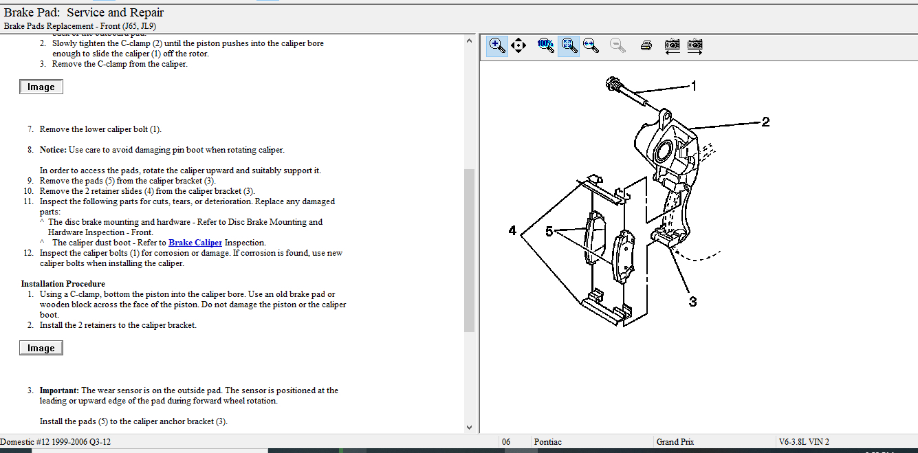

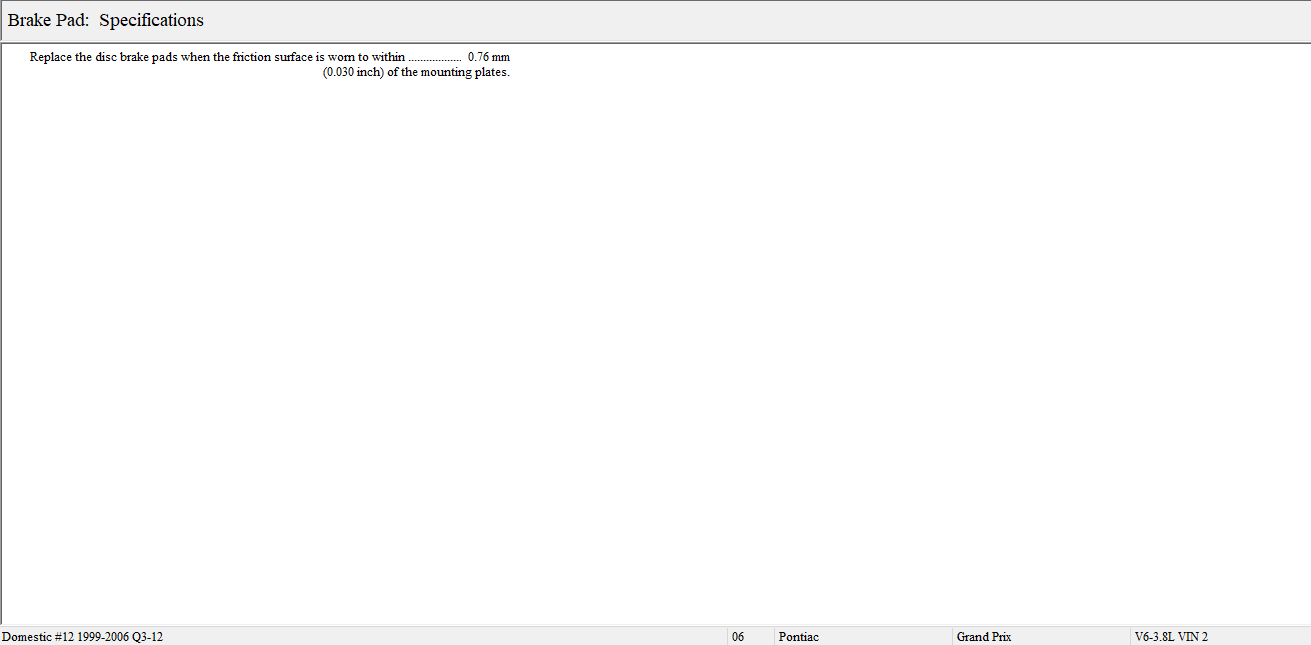

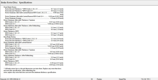

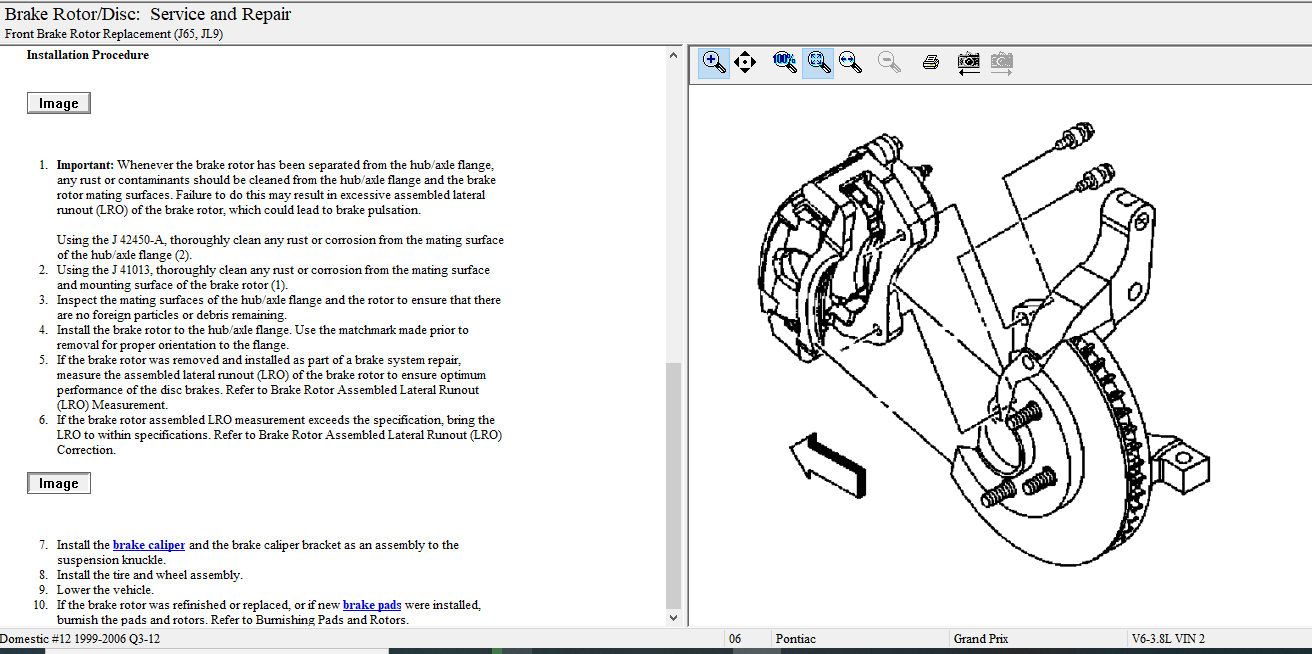

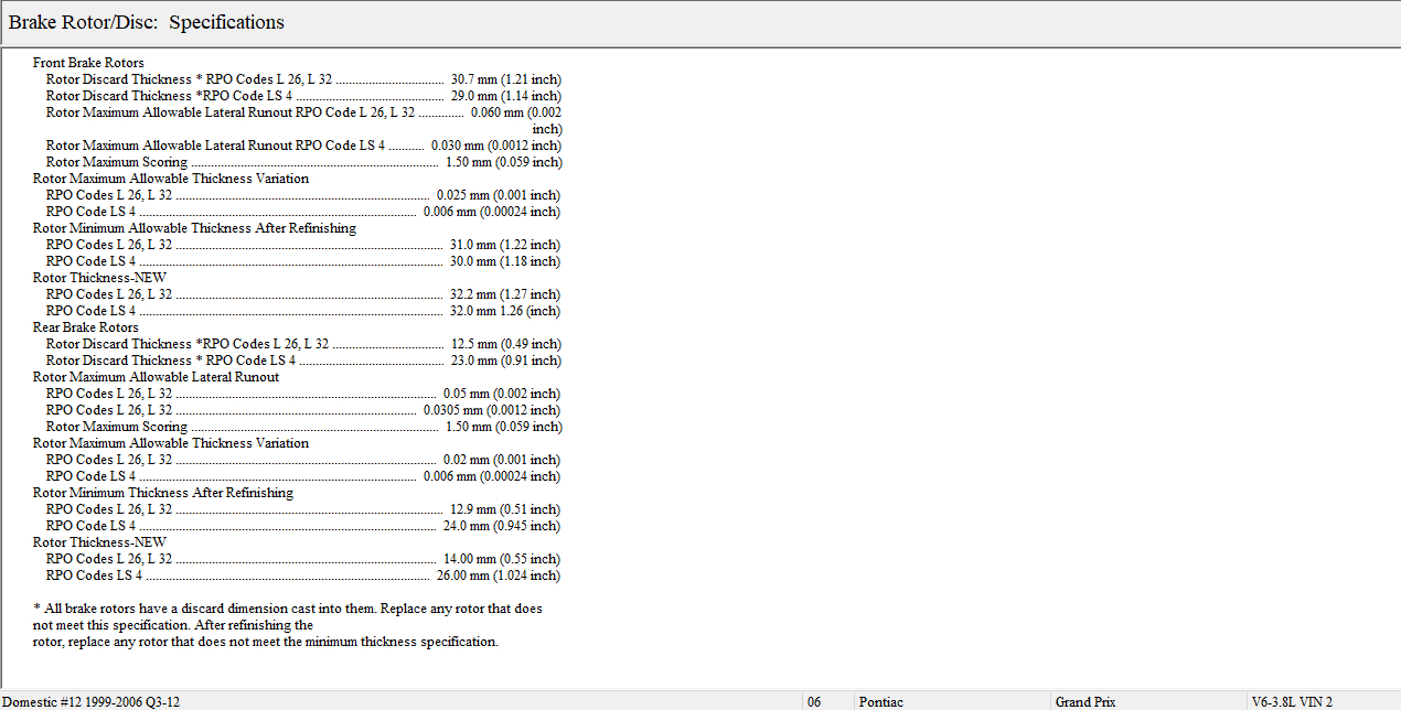

It sounds like brake pad wear indicator noise, front pads thickness lower than minimum must be replaced.

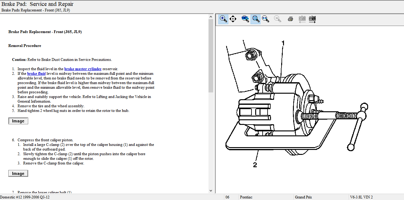

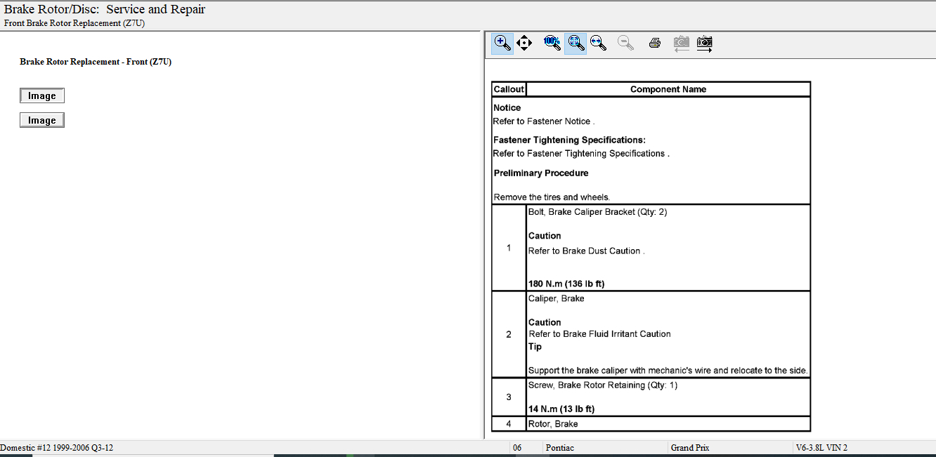

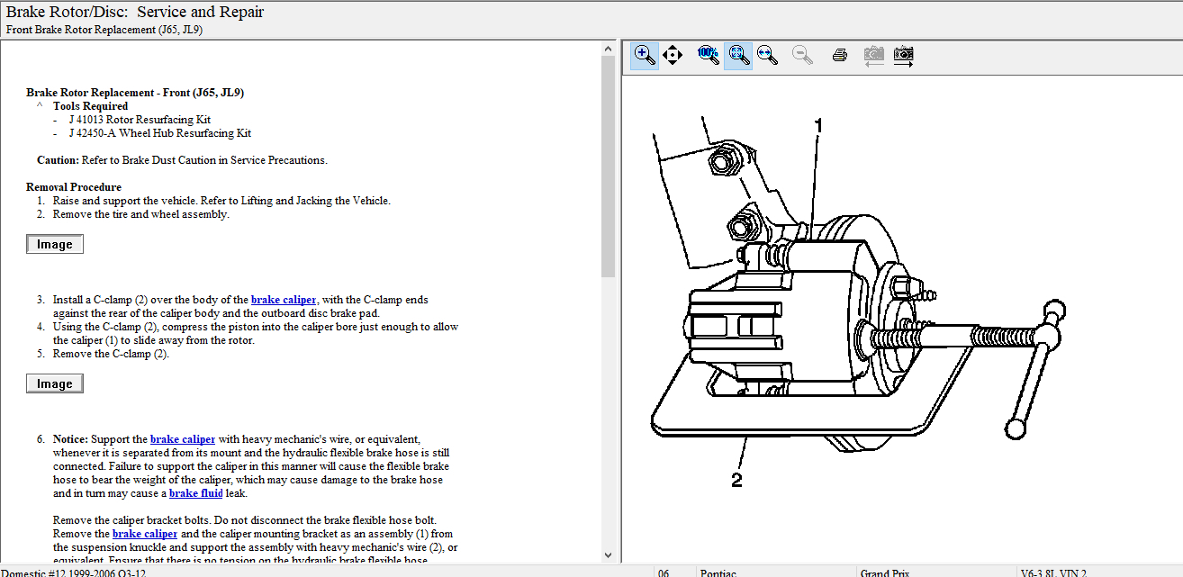

check our guide below how to replace front pads and rotors.
Check the diagrams below how to replace front pads and discs, for (j65,jl9) and (z7u) brake types.
let us know if you need more help.
