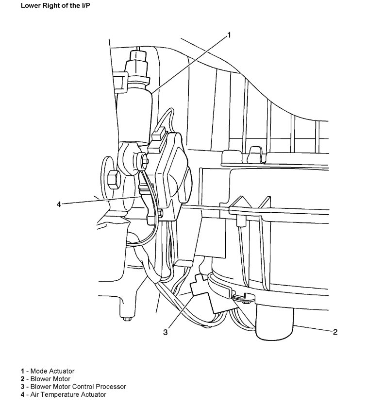

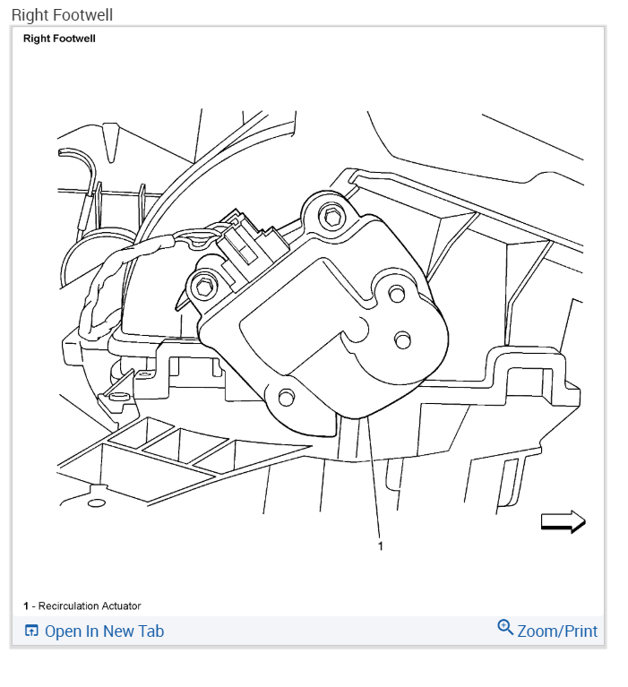

I need to find the blend doors and the blend door actuator, where are these things at under my dash?
Are they relatively easy to get to? I need to verify that my blend doors are working properly before it gets cold again.
I have dual climate controls
Sep 3, 2010 at 9:57 PM
FACTORYJACK
  • 4,159 POSTS
The blend doors are going to be in the HVAC case, or HVAC module, whichever you call it. The actuators(right or left) appear to be accessible either behind the glove box(rh), or on the left side with removal of the lower insulator panel. Are you having concerns with operation, and on which side?
Here is a guide to help walk you through the repair with the locations of the blend door actors in the diagrams below.

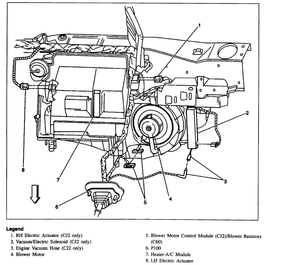

How to repair blend door in heating system of 97 grand prix where is it behind dash?
May 5, 2020 at 10:34 AM (Merged)
SATURNTECH9
  • 30,869 POSTS
All blend door actuators are behind the dash is various places. Here is a guide that will give you an idea of what you are in for when doing the job.

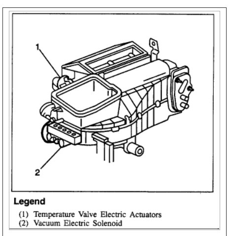

JIMMYD
Heat comes out the passenger side but not the drivers side
Will not switch , Just stays on passenger side

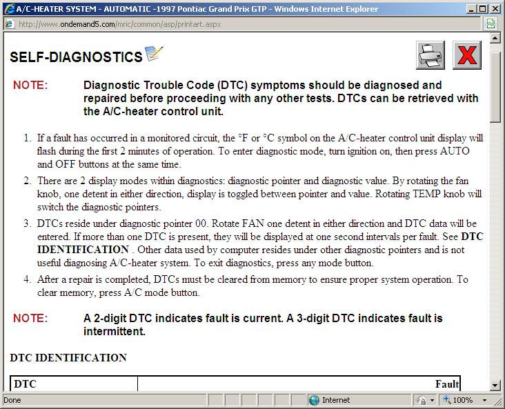

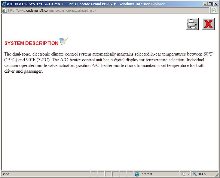

SATURNTECH9
  • 30,869 POSTS

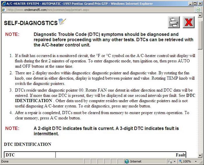

You have dual temp auto climate control correct where it reads out each sides temp settings? For the dual climate control you have two blend doors with two different vacuum actuators controlling it with two different temp sensors for each side so its more then start tearing stuff apart.I also posted how to retrieve codes that are starting point let me know if you have any codes.
JIMMYD
Thank You, I changed the actuator and now everything works little tough to get to. Thanks for hanging int here will me.

RYAN WILSON

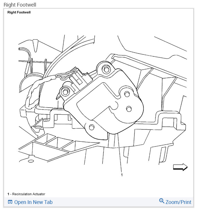

Can someone please for this exact thing help me find the location. I’m struggling hard to find it.
RYAN WILSON
Or at least which side I don’t have dual climate tho.
  • 54,861 POSTS
I found this location of the blend door actor diagrams for you. Check out the diagrams (below). Please let us know if you need anything else to get the problem fixed.
RYAN WILSON
Thanks, I found it and got it done.
