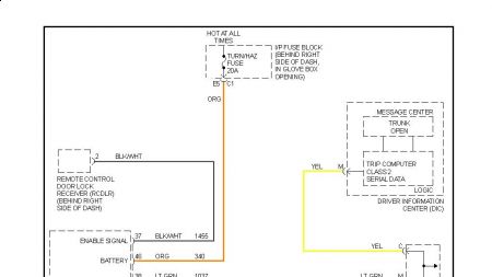

I made a donation and really need help figuring out why my trunk will not open.

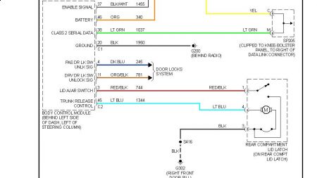

Hi rockbottom222000 and TY for the donation were sorry about the delay I just noticed this thread and willing to help here -Check the turn and hazard fuse 10amp if okay-Your problem could be coming from the remote control doorlock receiver behind right side of dash or the body control module behind left side of dash left of steering column. double check for loose wiring connectors on them . Also check the ground point G302 at right front door sill-See below electrical diagram.

Hey rasmataz thanks for the reply. I already checked the hazard fuse and it was good. What does the bcm look like so i can check to see if all wires are plugged in securely. Also, I can not read the diagram you sent me, could you please send it to my email. Thanks. schafdogg44@hotmail.com

Trunk release circuit-diagram
