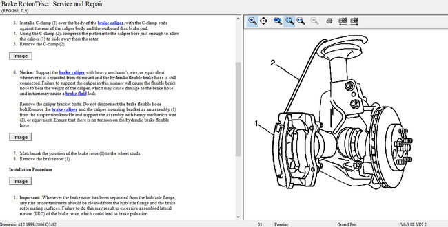

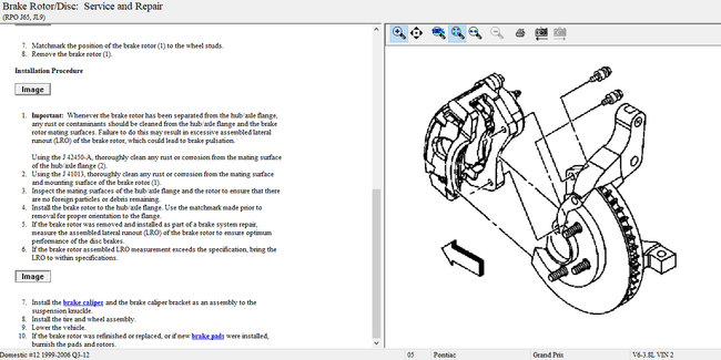

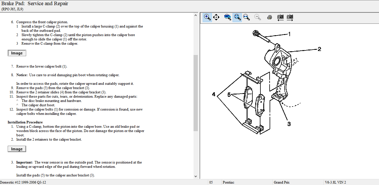

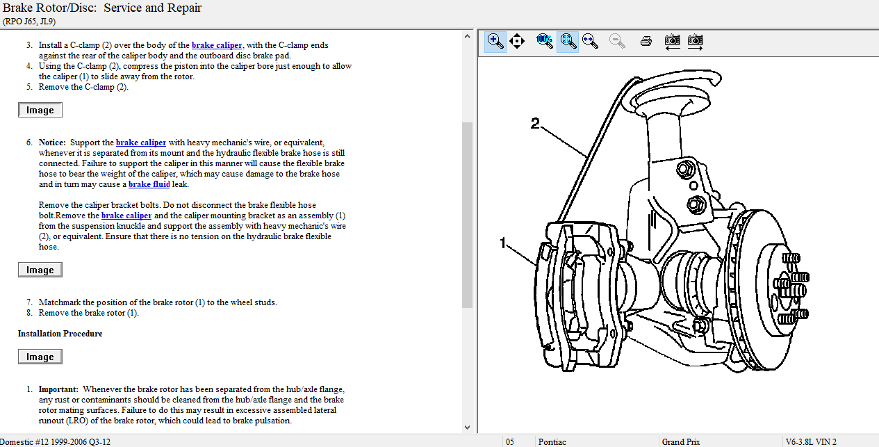

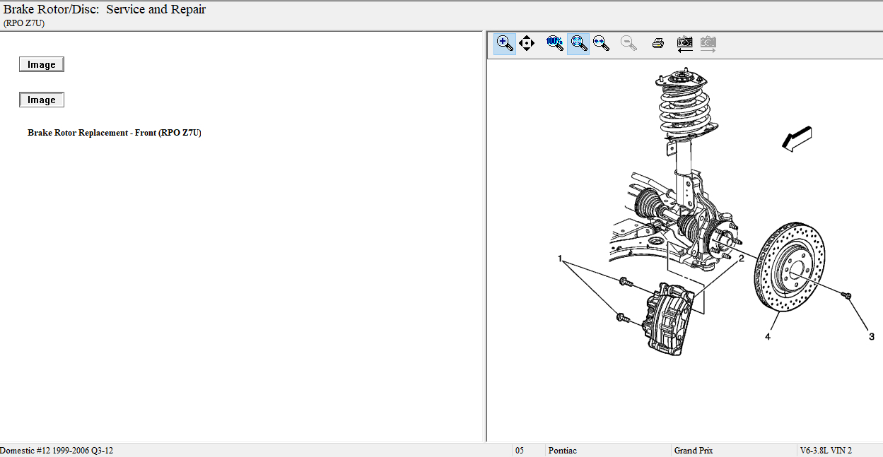

I need to do a brake job this weekend can you help me please?
Aug 13, 2009 at 2:40 AM
SEVAG P
Experienced Mechanic
405 POSTS

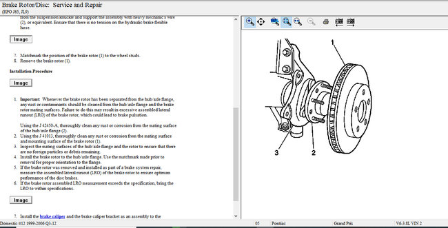

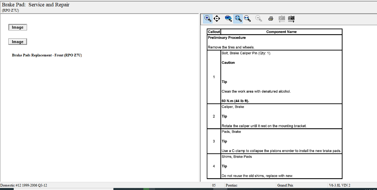

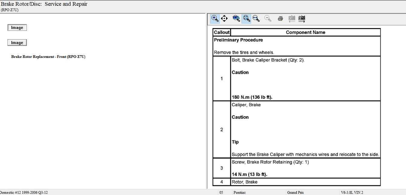

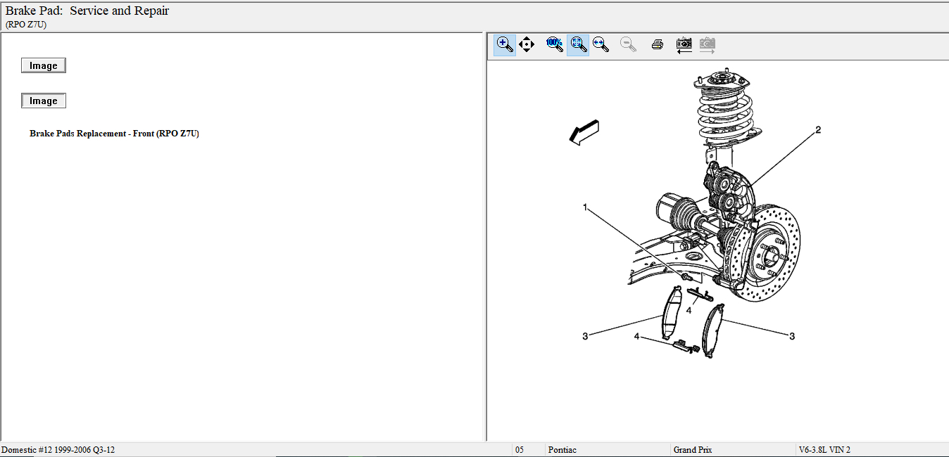

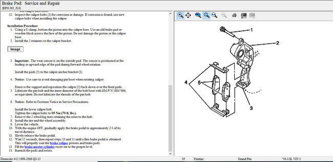

hello,

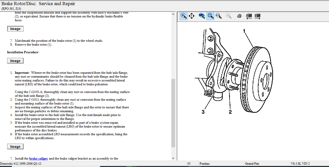

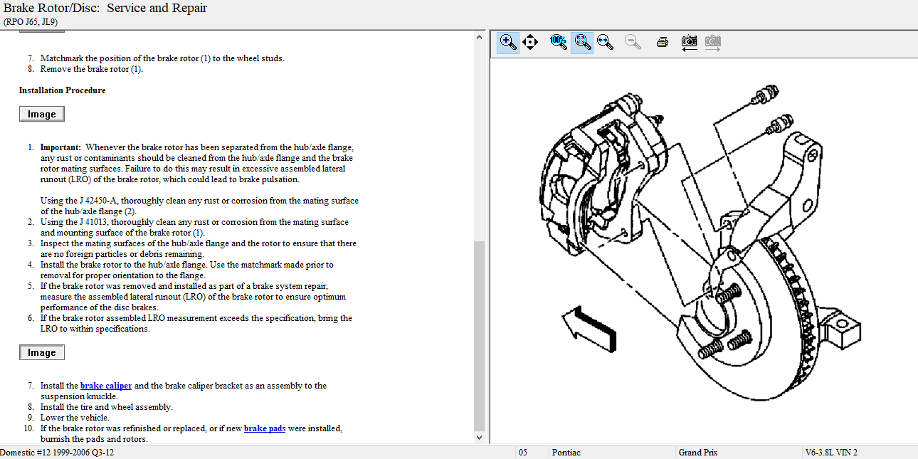

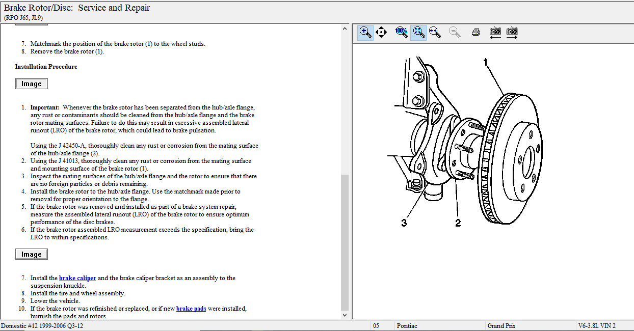

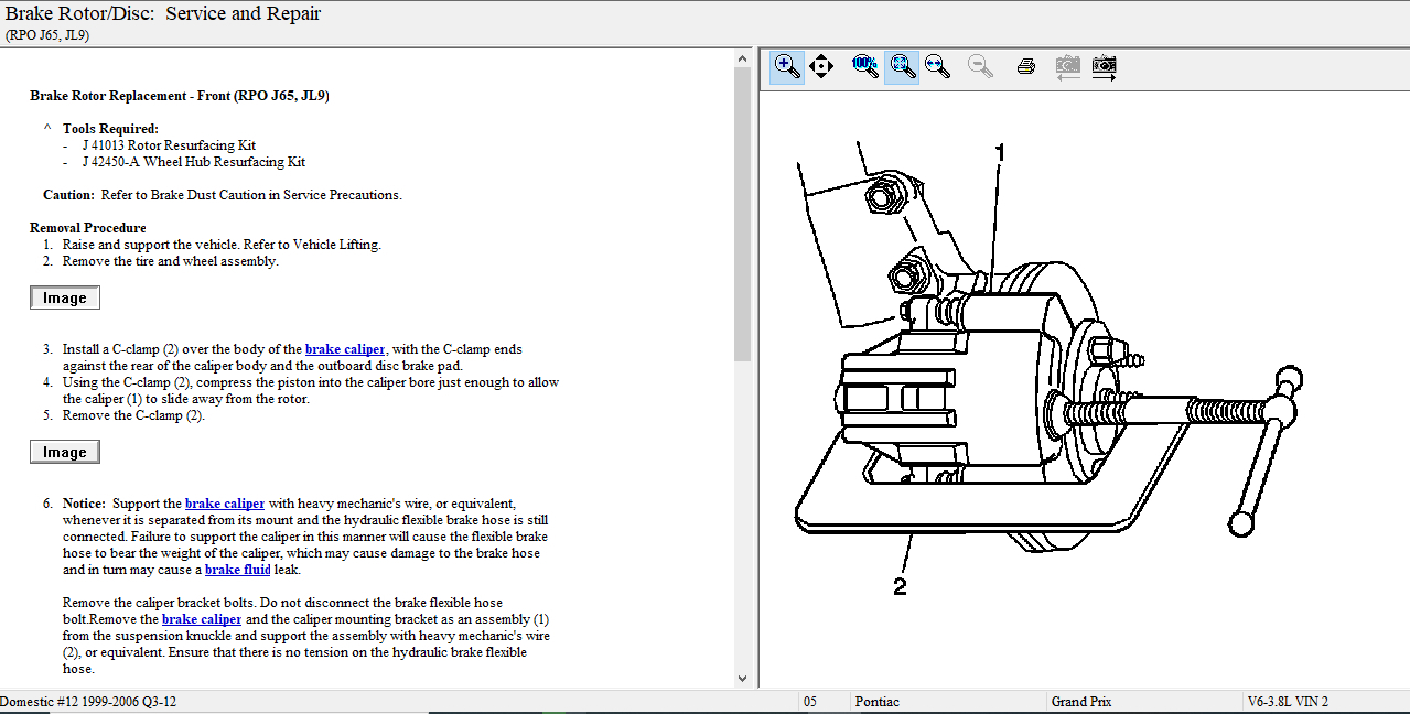

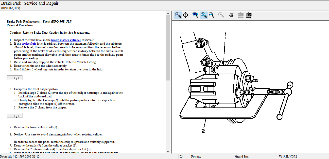

Check our guide below how to replace front brake pads and discs.
Check the diagrams below procedure how to replace front pads and brake discs.
hope these helps.
thank you.
