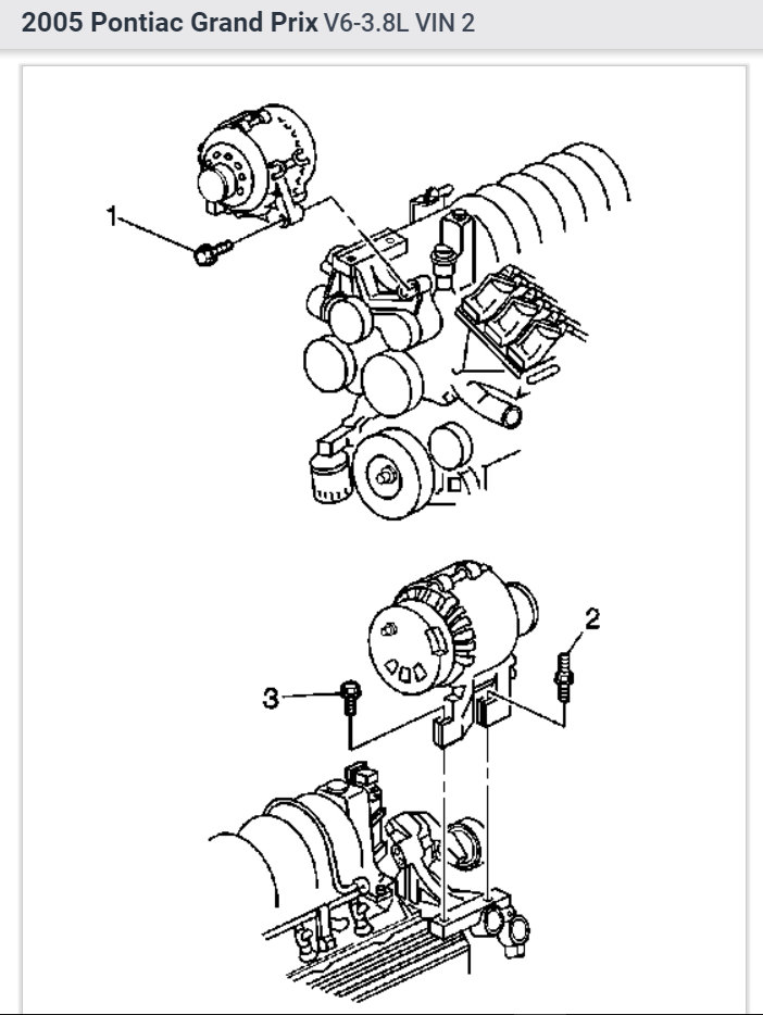

My info screen said charging system failing followed by a little picture of a battery. I do not know much about cars, so if you could tell me what that means I would appreciate it.

It sounds like the alternator has gone out which is common. Here is a guide to help you see the steps it takes to change it with diagrams below to show you on your car:
https://www.2carpros.com/articles/how-to-replace-an-alternator
2. Install the positive battery lead to the generator.
Note: Refer to Fastener Notice in Service Precautions.
3. Install the generator output BAT terminal nut.
Tighten the nut to 20 N.m (15 lb ft).
4. Install the protective boot to the generator output BAT terminal.
5. Connect the electrical connector to the generator.
6. Do not tighten the stud.
IMPORTANT: Install the generator stud (2) to the generator bracket.
7. Install the generator bolts (1, 3) to the generator bracket.
IMPORTANT: Do not tighten the bolts.
8. Tighten the generator bolts and stud in the order described. The following is a mandatory torque sequence:
1. Tighten the bolt (1) to 50 N.m (37 lb ft).
2. Tighten the stud (2) to 50 N.m (37 lb ft).
3. Tighten the rear bracket bolt (3) to 50 N.m (37 lb ft).
9. Install the generator rear brace.
10. Install the drive belt.
11. Connect the negative battery negative cable.
