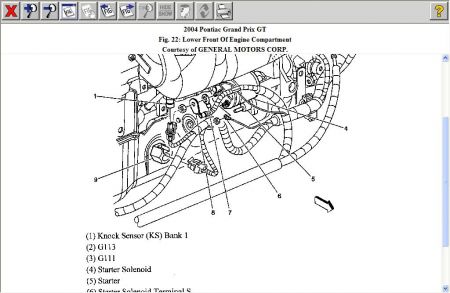

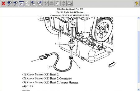

I recently had my car ran on a scanner, and it is coding the knock sensor. So my question where is the senor at and is it difficult to change. I could really use some help here cause i need my car fixed quick, it is running horrible!!!

You got 2 of them see below
https://images.2carpros.com/forum/automotive_pictures/12900_ks1_1.jpg
https://images.2carpros.com/forum/automotive_pictures/12900_ks2_1.jpg
