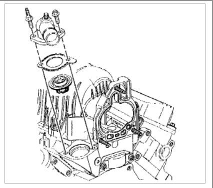

The temperature on my car fluctuates every time I stop. I was wondering if it might be the thermostat, or is there some kind of sensor. Where is the thermostat located?
Oct 16, 2009 at 2:26 AM
  • 55,224 POSTS
Hello, you should start by draining the coolant. here is a guide for that:
https://www.2carpros.com/articles/coolant-flush-and-refill-all-cars

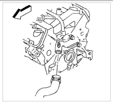

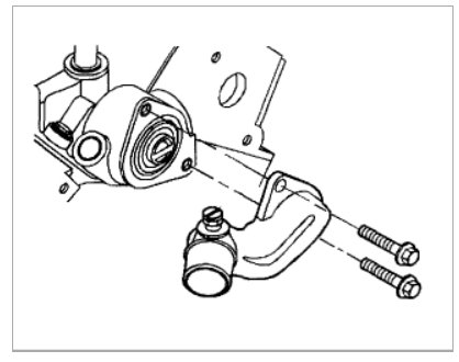

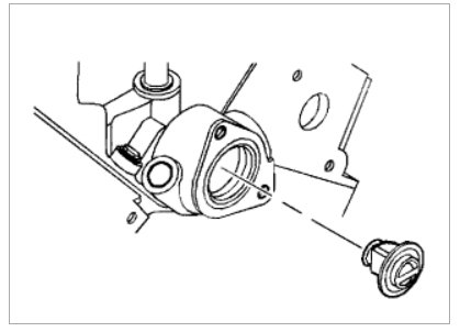

Here is a guide that will give you an idea of what you are in for when doing the job:
Here is what it will be lie on your car (below):
Tighten the water outlet housing bolts to 25 Nm (18 ft. lbs.)

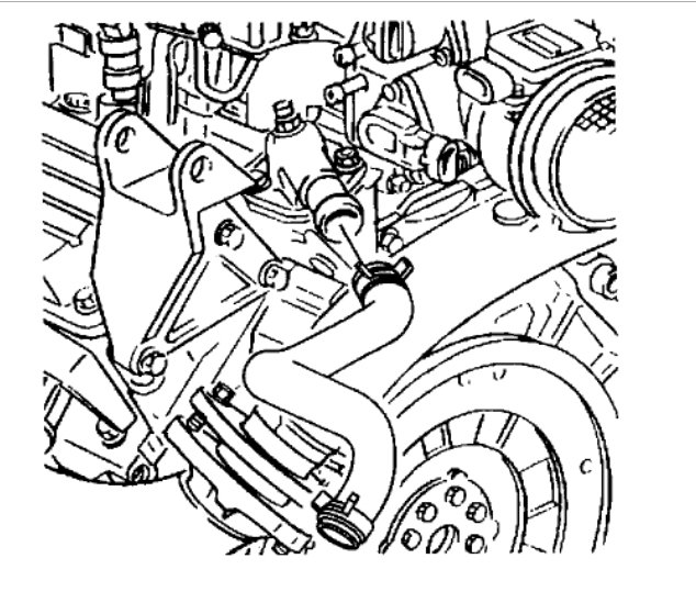

MASTERTECHTIM
  • 4,750 POSTS
if you have a 3.4 l engine it is located under the throttle body. just follow the upper radiator hose to engine, the part it connects to is the thermostat housing. hope this helps. remember feedback and votes for me are greatly appreciated

ERNEST CLARK
  • 1,730 POSTS
Your thermostat is located right next to the throttle body towards the front of the car. You need to remove the injector cover to get to it.
You have two radiator hoses. One goes to the water pump, the other goes to the thermostat housing. Follow the hoses and you'll find your thermostat.
