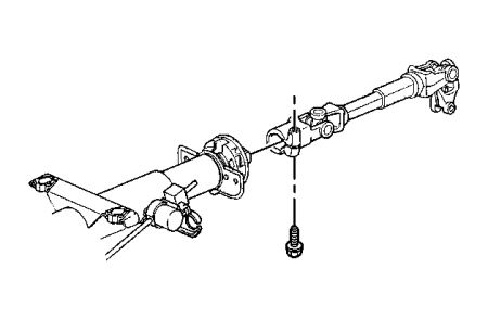

Does anyone have instructions/diagrams on how to replace the ISS? There are known problems with the original ISS which now GM has recommended lubing the ISS every 10K. They have also recommended replacing the ISS with GM#: 25913680
So I plan to buy the part and replace it.
Any help will be appreciated.
Thanks

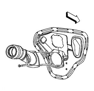

Ok so here are you pics of how to remove it. Now you will first remove the upper seal and then the lower seal and then the pinch bolts and remove. Here are the pic in that order. Upper shaft seal
https://images.2carpros.com/forum/automotive_pictures/249564_Graphic1_28.jpg
Lower shaft seal
https://images.2carpros.com/forum/automotive_pictures/249564_Graphic2_10.jpg
Pinch bolts
https://images.2carpros.com/forum/automotive_pictures/249564_Graphic_175.jpg
