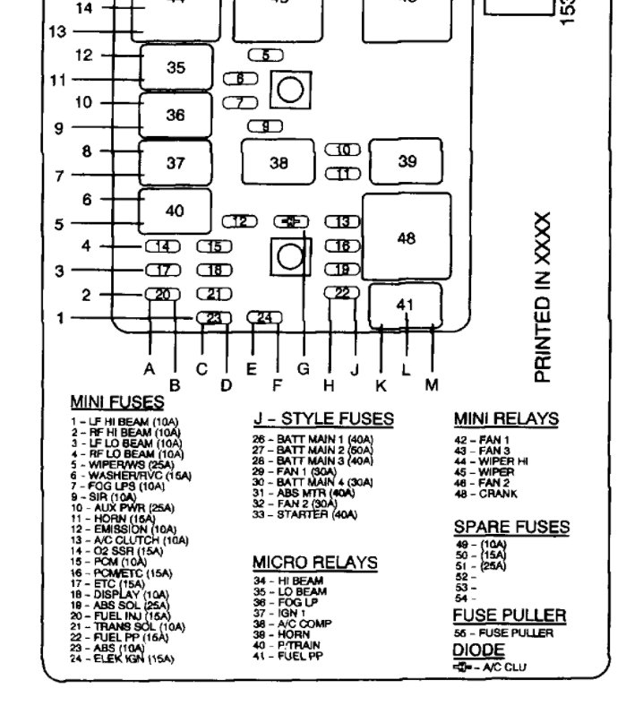

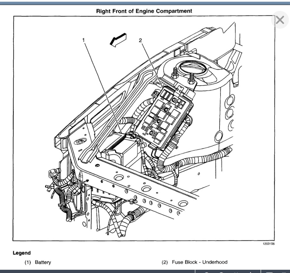

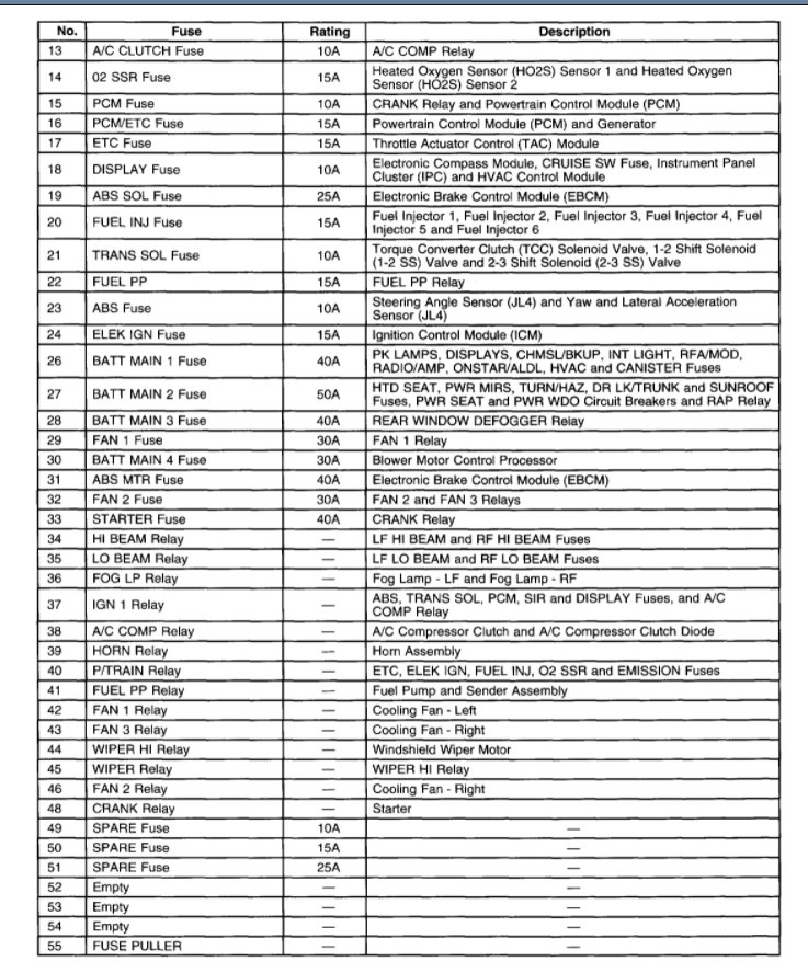

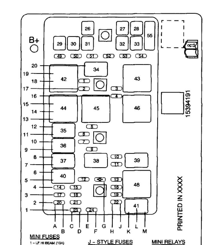

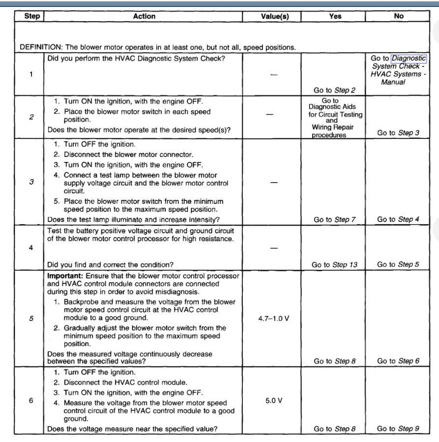

where is the fan motor switch located on 2004 grand prix , motor fan stopped working
Jun 29, 2009 at 5:04 AM

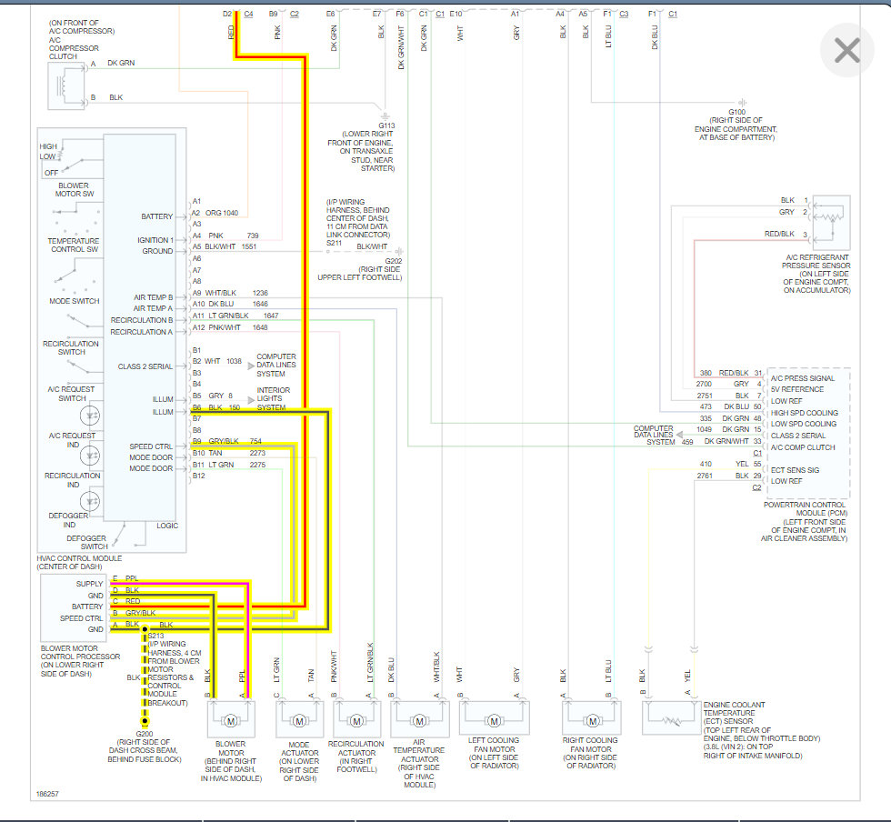

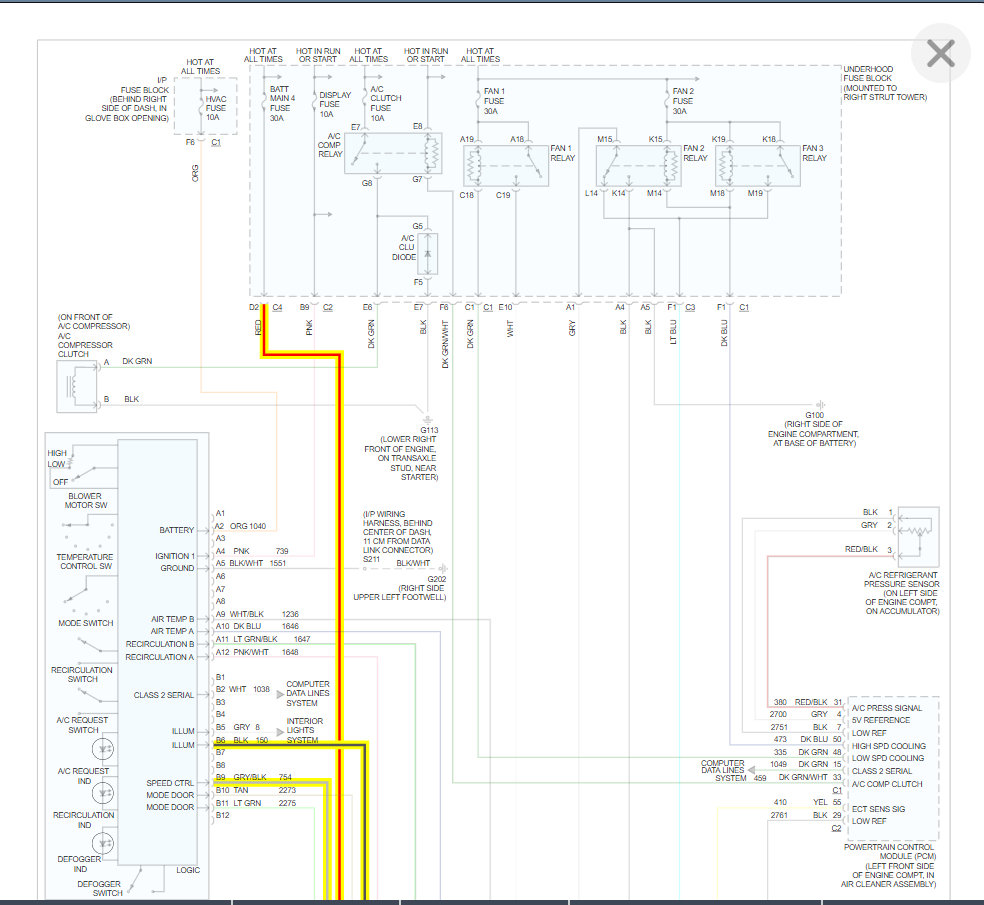

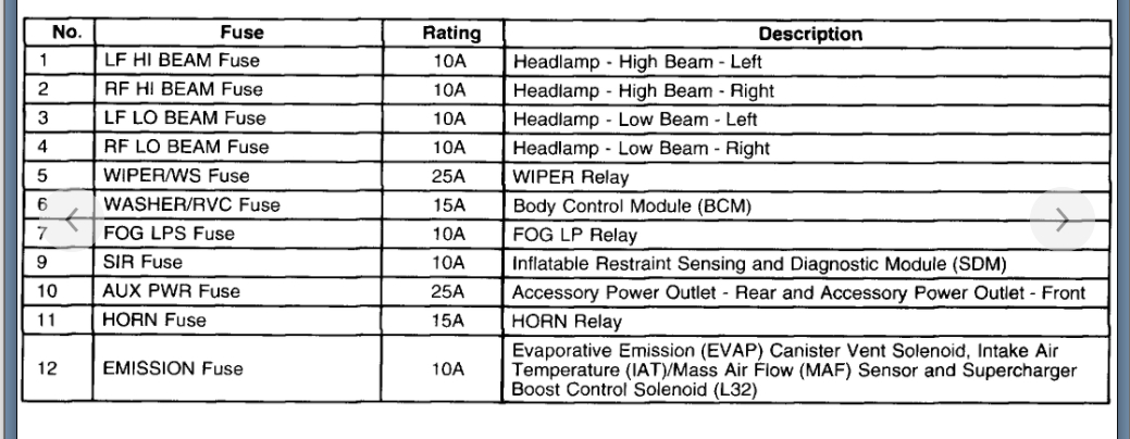

The blower motor uses the main fuse but has a resistor called a control processor as well. So if you are talking about the fuse then I attached the info below on this.
https://www.2carpros.com/articles/blower-fan-motor-works-on-high-speed-only

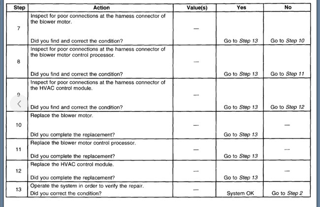

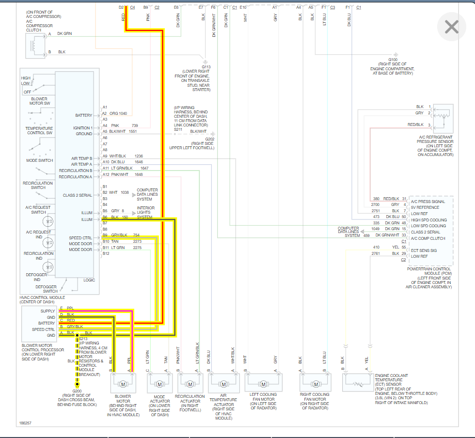

If you are looking for the processor/resistor then that is next to the blower motor under the passenger side of the dash.

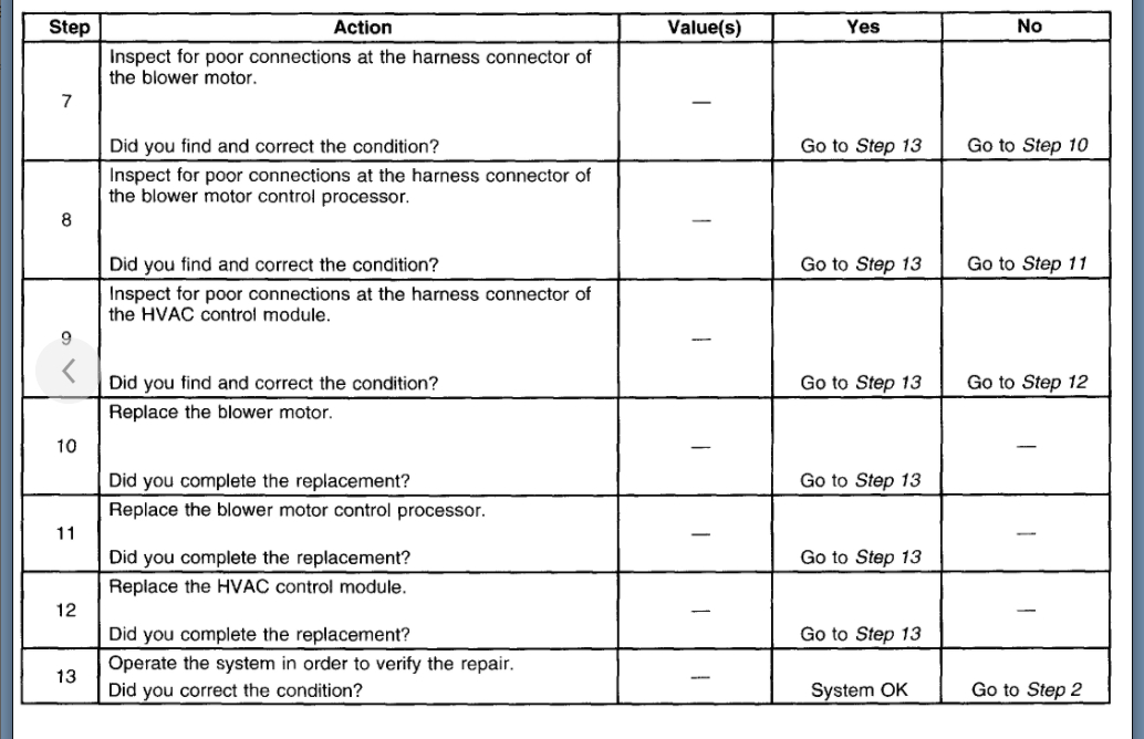

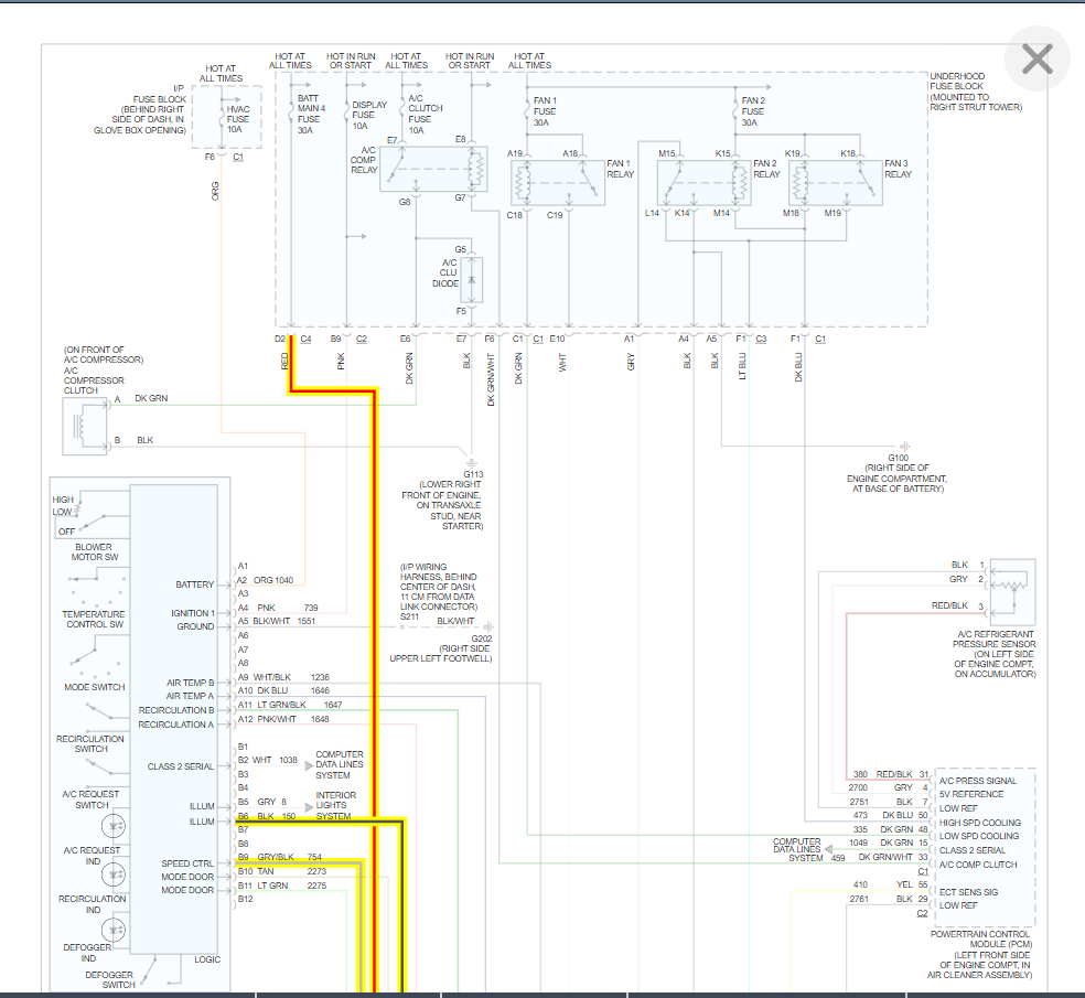

However, I am attaching the complete info below on the blower motor not working. Including the wiring diagram and testing on how to test a blower motor that is not working.
Please run through all this info and let us know if you have other questions.
