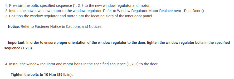

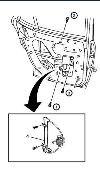

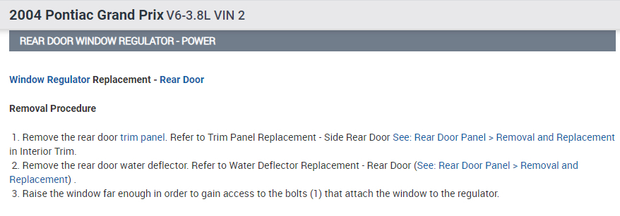

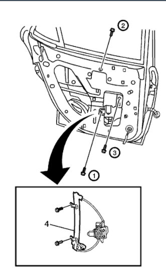

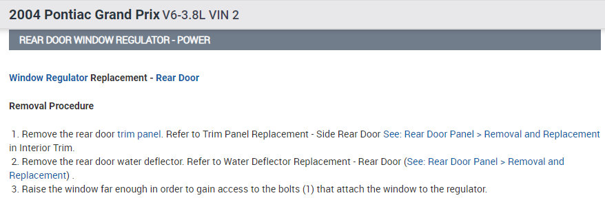

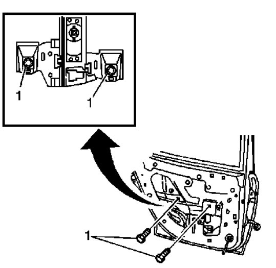

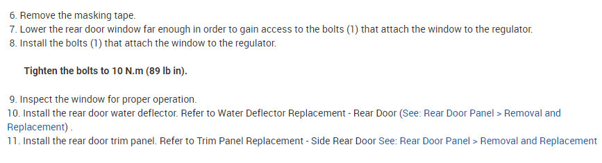

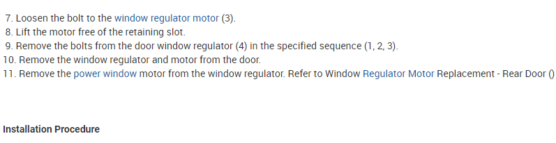

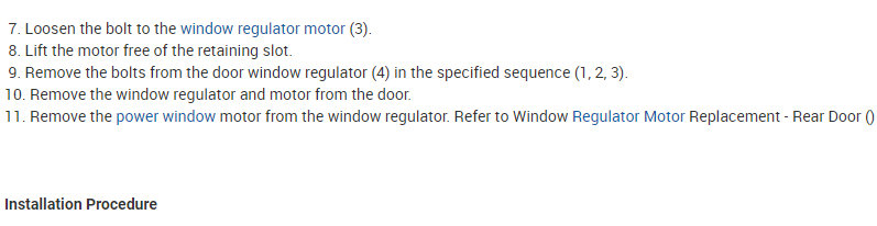

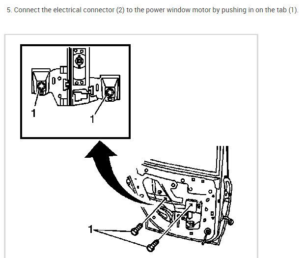

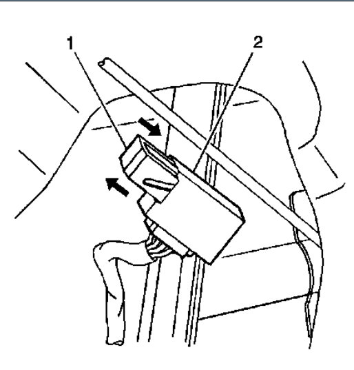

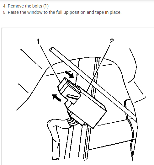

How do you replace a rear window regulator?
Thursday, August 13th, 2009 AT 10:48 AM
DANNY L
  • 5,648 POSTS
Hello, I'm Danny.
Here is the information you requested. You will have to remove the door panel to gain access to the window regulator so here is a tutorial for door panel removal and installation and one for power window regulator replacement:
https://www.2carpros.com/articles/door-panel-removal
https://www.2carpros.com/articles/how-to-check-and-replace-a-electric-power-window-motor
I've attached picture steps below showing how to remove and replace the rear power window regulator on your vehicle. Hope this helps and thanks for using 2CarPros.
