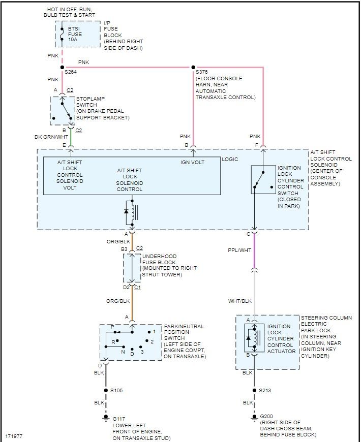

My car starts but it won't shift out of park. I have to push the shift/lock release button next to the gear shifter.
One morning it worked fine, and then i went to drive away after work and it stayed in park. I had my foot down on the brake, and i even checked the emergency brake. It just feels like its locked.
