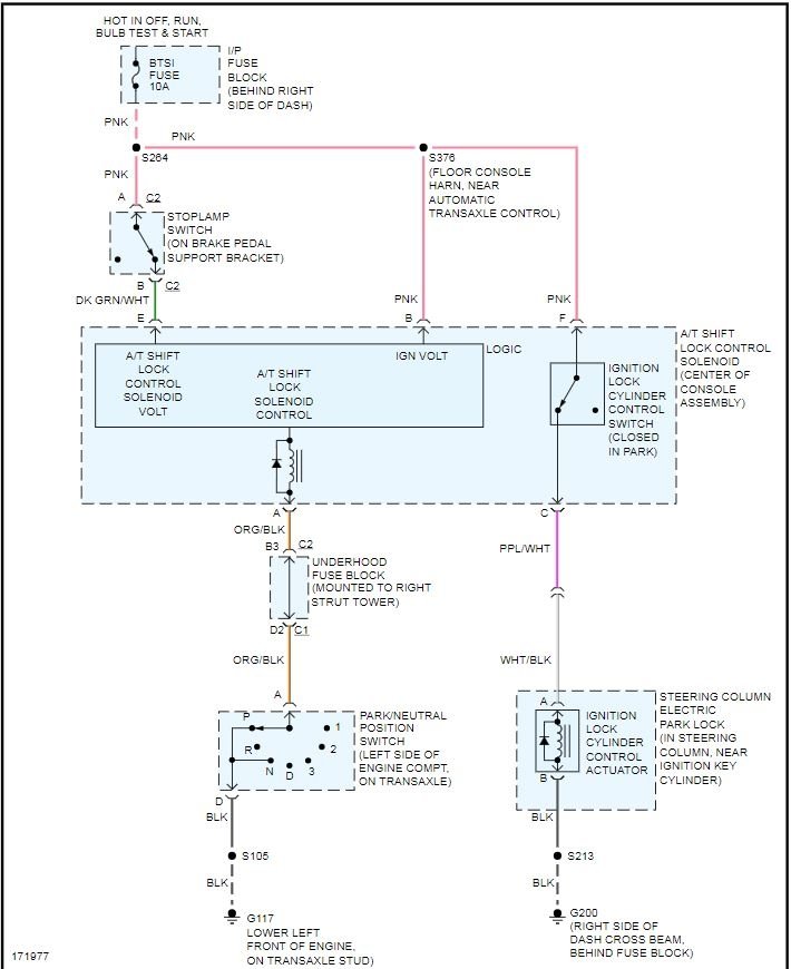

My car starts but it won't shift out of park. I have to push the shift/lock release button next to the gear shifter.
One morning it worked fine, and then i went to drive away after work and it stayed in park. I had my foot down on the brake, and i even checked the emergency brake. It just feels like its locked.

Check to see if the brake lights are working, both the lights and shift interlock use the same brake switch. Start with fuses
Read this guide on using a test light, good way to check for power
The wiring diagram for the shift interlock is attached below

That would be called the shift interlock feature. It operates on the same circuit as the brake lights so the first thing you want to do is to make sure the brake lights are working when this problem is present. If the brake lights are working, that proves the circuit is good up to that point, then you'll have to get to the solenoid in the console. Disassemble as much as you have to to access the solenoid near the shifting mechanism. Us a 12v test light to test for power coming and going at the solenoid when the brake is applied. If power is arriving and switching and the solenoid is not triggering, the solenoid is bad and will have to be replaced.

Have the shift interlock system check-could be the shift lock solenoid that you're hearing

I think you should check the brake switch it controls the cruise control and the shift interlock system

Most likely the button mechanisim has broke. There is a plastic plunger that activates the release.
Could also be the brake solenoid, this prevents the shifter from moving unless brake pedal is depressed.
But it is certainly not a trans problem, from your description.
You will have to remove shifter knob and inspect the plastic plunger, then remove console base and inspect the shifter hardware for loose parts.

Brake pedal must be depressed to shift out of park, if it won't, there should be a small button on shift console, depress brake and push button, if shifter works, then the park/lock safety switch is bad.

most likely a failed park/neutral safety switch but first ensure brake lights are working, if they are not than the brake light switch may be at fault.
