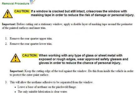

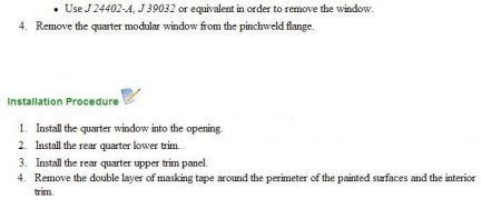

How do you remove the rear door fixed quarter window
of a 2003 pontiac grand prix ?
