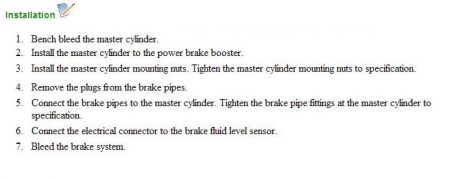

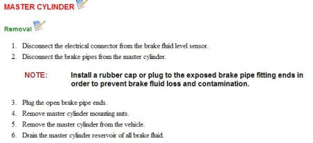

How do you change a brake master cylinder

https://images.2carpros.com/forum/automotive_pictures/261618_Noname_1058.jpg
https://images.2carpros.com/forum/automotive_pictures/261618_Noname2_302.jpg
