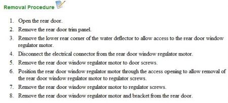

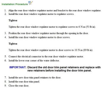

I want to know how to replace a rear passenger electric window motor and regulator.

https://images.2carpros.com/forum/automotive_pictures/261618_Noname_2438.jpg
https://images.2carpros.com/forum/automotive_pictures/261618_Noname2_795.jpg
