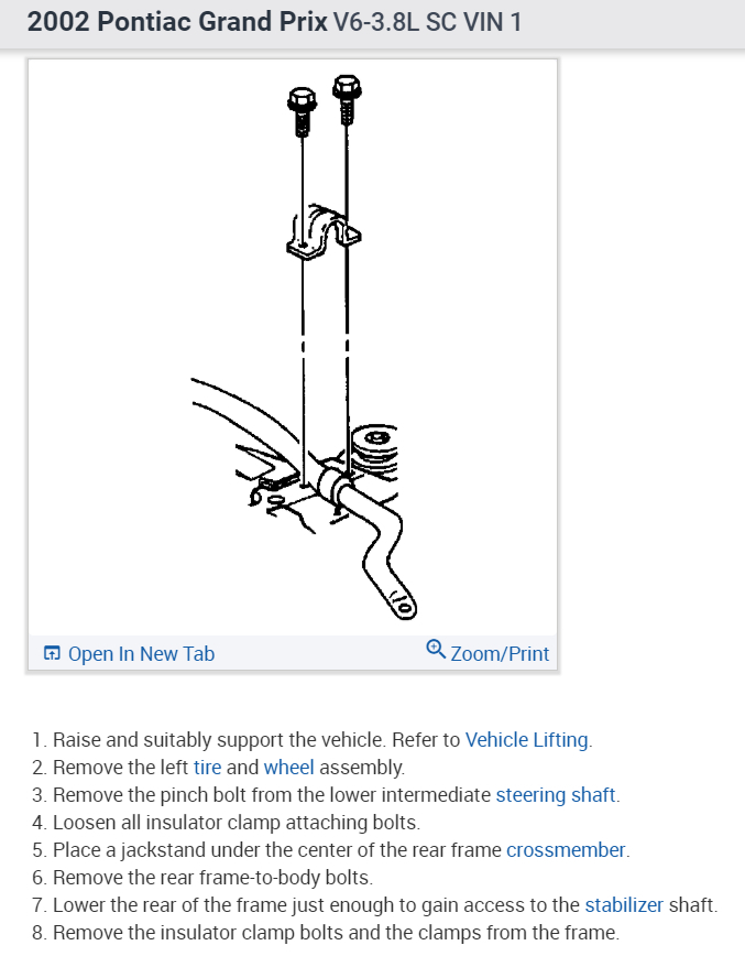

I am having an issue with the install of the new sway bar. It appears to be rubbing against the tie rods? any suggestions?
Sep 16, 2010 at 2:31 PM
  • 110,240 POSTS

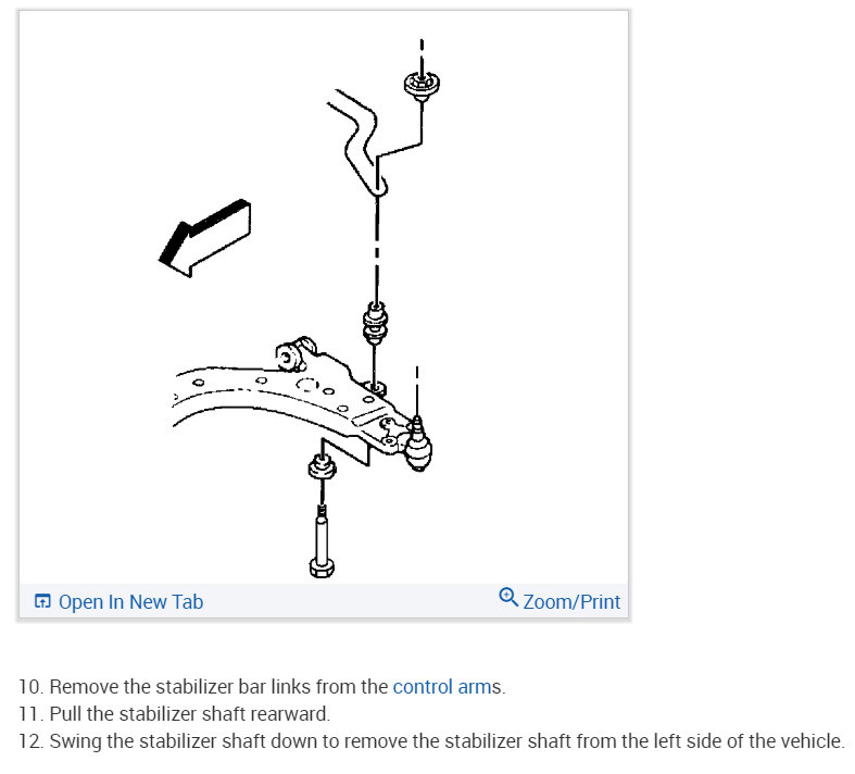

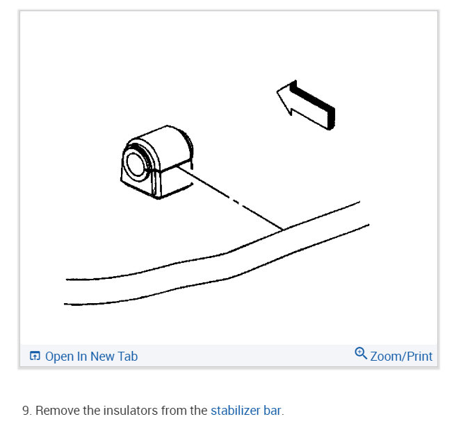

It seems you have the wrong sway bar but to be sure here are diagrams below so you can see what's going on. Check out the diagrams (Below). Please let us know if you need anything else to get the problem fixed.
Sep 17, 2010 at 12:26 AM
