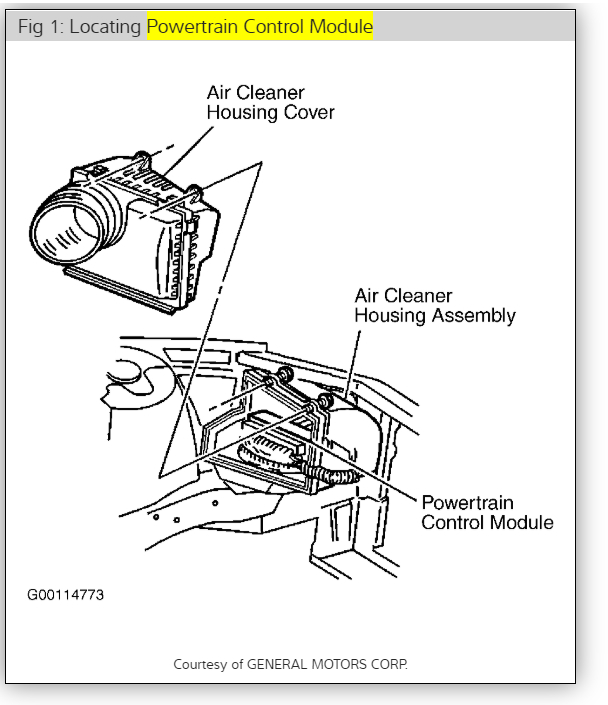

Location of this particular part please?
Jun 21, 2009 at 9:16 AM
MMPRINCE4000
  • 8,548 POSTS
Powertrain Control Module (PCM) Left front side of engine compartment, in air cleaner assembly. If you intend to replace it, the replacement will have to be re-flashed. Check out the diagrams (Below). Let us know what happens and please upload pictures or videos of the problem.
