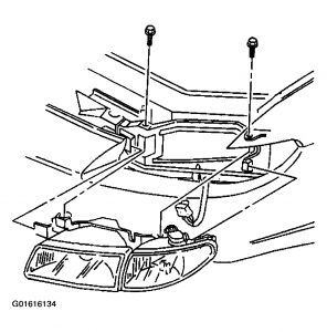

How do I gain access to the head lamps so I can replace the bulbs? It looks like I need to remove the batter on one side and the air filter system on the other. There must be an easier way.
Feb 2, 2009 at 6:27 PM
2CARPRO JACK
  • 11,533 POSTS
Remove the headlight assembly bolts from the upper fascia support
https://images.2carpros.com/forum/automotive_pictures/1639_pontiac1_1.jpg

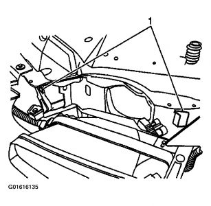

slide the light assembly out far enough to release the bracket tabs from the slots in the upper fascia support
https://images.2carpros.com/forum/automotive_pictures/1639_pontiac2_1.jpg
this will give you access to the rear to replace the bulbs
