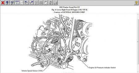

I need to replace my speed control sensor but I m not sure where it is? Could you help out? Thanks!

You sounded as though you're talking about the vehicle speed sensor-its located on lower right side of engine compartment on transaxle
