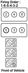

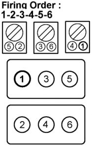

I had no idea I was suppose to put the wires back as there were, so when I got the "Bright" idea to change my wires I took all the wires off then now I don't know where they belong Helppppp
Feb 12, 2009 at 9:11 AM
OBXAUTOMEDIC
  • 3,711 POSTS
Hello, Here are the firing orders for the..... 3.1L
https://images.2carpros.com/forum/automotive_pictures/188069_01grndprix31_1.jpg
In the below images to find out what Vin you need just count to the 8th digit of the vin. 3.8L Vin 1 and vin k
https://images.2carpros.com/forum/automotive_pictures/188069_01grnprix38vin1_1.jpg
