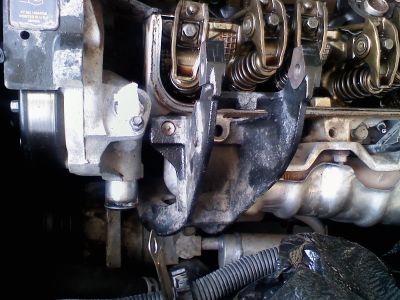

I am trying to change the head gasket on my 2001 pontiac grandprix and are having trouble removing the mounting bracket that is on the left side of the motor. I have removed all of the bolts but I cannot lift the mounting bracket enough off of the head bolt to move the bracket out of the way. Not sure what else to do... because I need to move that mounting bracket out of the way in order to get to and change the head gasket!!!!!

I'm not exactly sure which type of motor mount bracket it is but its a c type bracket that sits over the intake manifold

There aren't any head bolts in that area so I have no idea what your talking about.
A picture would help.

https://images.2carpros.com/forum/automotive_pictures/572126_downsized_0912001500a_3.jpg
the c type bracket wraps around the exhaust manifold and the bracket extends down. it is on the #5 headbolt accordning to the sequence from the hanes book.

That bolt has to be removed.
It's either a Torx or an Allen socket.

that bolt is the head bolt and i cant get to it without removing the bracket 1st.i cant take off the heat shield or the exhaust manifold either. the bracket sits on that bolt but when i go to pull up on the bracket it comes up but because it goes aroung the manifold it hits it. preventing me from taking it off the #5 head bolt.am going to send a few more pics. maybe that will help.the 1st 1` is of the bracket pulled up not wont come off the #5 head bolt, the 2nd 1 is of the what the bolt looks like under the bracket,and the 3rd is of where i took off 1 of the bolts to the bracket,

There are three bolts holding that bracket in place. One is right where you can see it the other two are on the A/C compressor. Remove them two bolts in A/C compressor along with motor mount bracket bolt and it will come free:D
