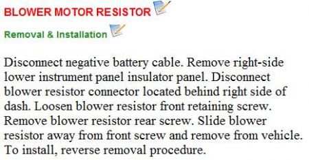

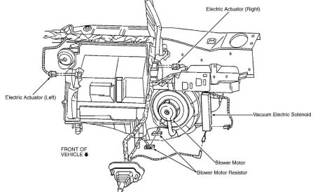

My ac only works on 5 (high) or when I put it on maxiumum air. What could be the problem. Occassionally it does not blow at all.
Tuesday, June 2nd, 2009 AT 6:05 PM
ZACKMAN
MECHANIC
4,202 POSTS
Replace your blower motor resistor.
