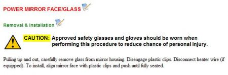

Driver door miror has broken, only the glass miror is broken how is it rplaced ? Does a whole new assembly need to be purchased and installed on the door?

You can replace the glass only, read below for details..
https://images.2carpros.com/forum/automotive_pictures/261618_Noname_1327.jpg
