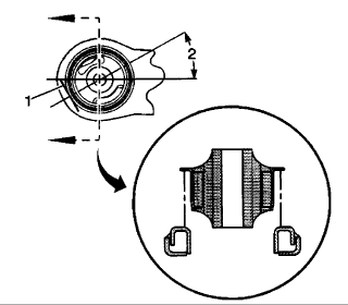

The front control arm bushing on a 2000 Grand Prix needs to be aligned a particular way when installed due to it's design. GM states this in their manual for this car but doesn't make it very clear in their description and picture. Do you know what the correct installation alignment is?
Apr 27, 2011 at 3:54 PM
MCFERRANCE
  • 100 POSTS
I have figured this out. The bushing is originally installed from the bottom of the driver's side and the top of the passenger side control arms. The pictured shown above shows marking the flat spot before removing the bushing but it shows it in the wrong place. The picture I have attached is the one in GM's manual and correctly shows where the flat should be which basically aligns the solid part of the bushing in direct relation to the angle that the balljoint is from it. This makes sense with its effect on handling and the whole geometry of the front suspension.
