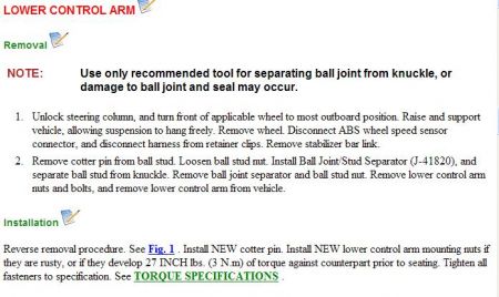

How do I change the control arms?

Removal of lower control arms as per text. mark (mhpautos)
https://images.2carpros.com/forum/automotive_pictures/61395_Noname_2.jpg
