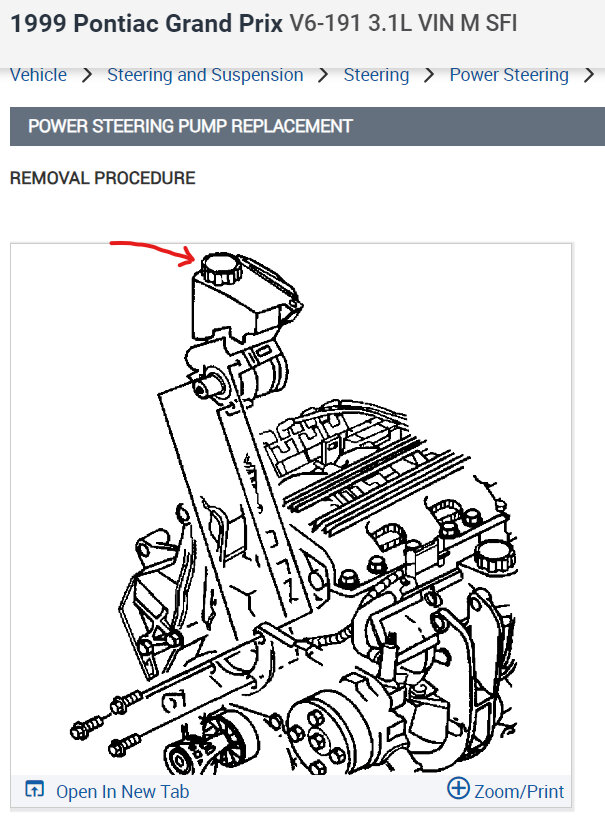

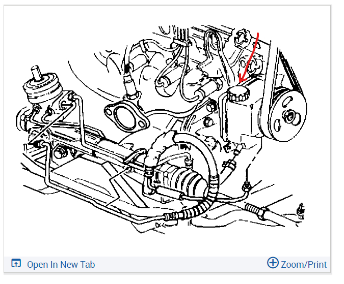

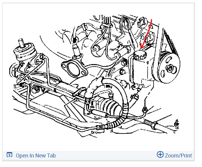

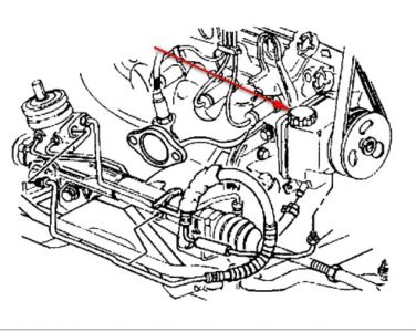

There is a "whine" when the engine is running that sounds like the power steering pump. I can't find anywhere to add power steering fluid. It is a V6 3.8 liter 3800 seris II engine

What engine do you have? Here is the location of the fluid reservoir for the 3.1 and 3.8 liter. Check out the images (below). Please let us know what happens.

The reservoir is right on the pump, passenger side, to the rear.
