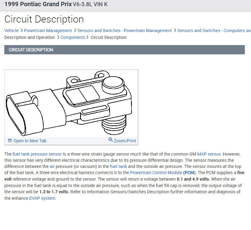

where is the fuel tank pressure sensor located on a 99 grand prix gt?
Aug 22, 2008 at 12:44 PM
SQM
  • 6,383 POSTS

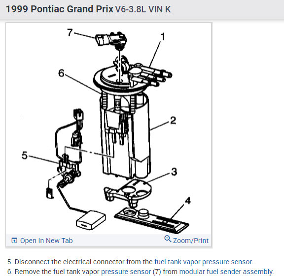

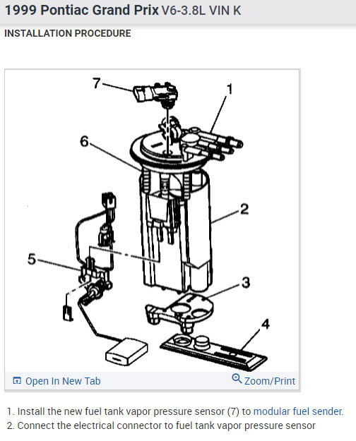

The fuel tank pressure sensor is located on the top of the fuel pump sending unit.

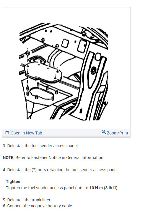

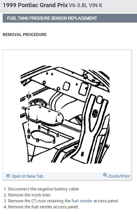

In order to access it you will have to remove the trunk liner and you will see a access panel on the trunk.
Remove the panel and it will expose the top of the fuel pump sending unit. On the top center of the unit is the pressure sensor (see diagram).
