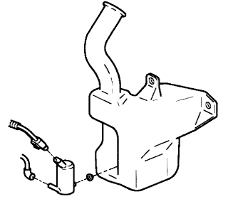

What are the steps in installing a new windsheild washer pump?

Locate the washer bottle, the pump should be mounted in the bottom of it. Sometimes removal of the resevoir is required and sometimes not. While it is apart, verify power is getting to the motor when you use the wash setting on the switch

I have attached the info requested
https://www.2carpros.com/forum/automotive_pictures/248015_Washer_Pump_1.gif
REMOVAL PROCEDURE
Remove the front fender liner.
Disconnect the electrical connector and the hose from the washer pump.
Remove the washer pump from the washer solvent container.
3.1. Pull the top of the washer pump out from the side of the washer solvent container.
3.2. Pull the washer pump out of the washer solvent container.
Remove the washer pump seal from the washer solvent container.
INSTALLATION PROCEDURE
Install the washer pump seal into the washer solvent container.
Install the washer pump into the washer solvent container.
2.1. Push the washer pump inlet into the washer solvent container completely.
2.2. Push the top of the washer pump into the side of the washer solvent container.
Connect the electrical connector and the hose to the washer pump.
Install the front tender liner.
