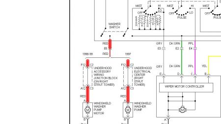

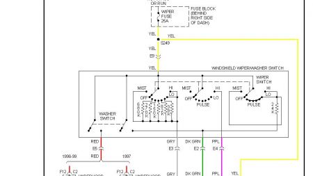

I can't locate the power supply or fuse for the windshield washer solvent pump.
Thursday, April 24th, 2008 AT 4:24 PM
MECHANIC
75,992 POSTS
The power supply for the washer pump comes from the wiper fuse 25amp thru the wiper/washe switch then to the washer pump. See below
