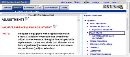

is valve lash adjustable in this engine
Mar 20, 2009 at 2:54 AM
  • 75,992 POSTS
See below info
https://images.2carpros.com/forum/automotive_pictures/12900_valve_lash_1.jpg
