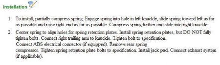

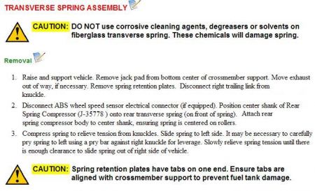

How do you remove and install a tranverse leaf spring on a 1994 pontiac grand prix.

https://images.2carpros.com/forum/automotive_pictures/261618_Noname_1023.jpg
https://images.2carpros.com/forum/automotive_pictures/261618_Noname2_291.jpg
