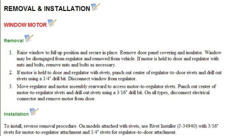

how to remove window regulator motor
Nov 7, 2009 at 9:06 AM
BLUELIGHTNIN6
  • 16,542 POSTS
https://images.2carpros.com/forum/automotive_pictures/261618_Noname_1160.jpg
Nov 7, 2009 at 9:11 AM
