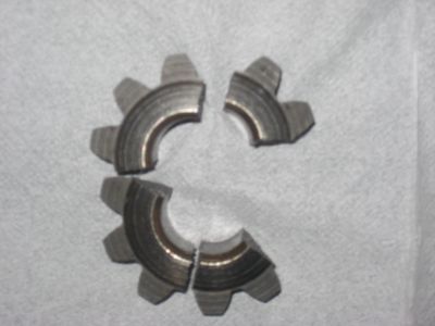

I know its been a while since the problem started. Ive been busy with school and havent had time to look into anything. Now that its summer, I need to get my car running!!! First of all the car is a 2003, not a 1993. I must have put that in my frantic search to fix it. My mistake and I apologize. Second, there was another piece that broke off under the car. It looks like it was covering the area where the gear came out of. It under the trans and engine of the car. Here is the picture of the broken gear.

This looks like a differential side gear or spider gear, was this on the ground? if so the the diff unit has suffered a major mechanical failure and will be unrepairable, as the case had smashed as well, will do a bit of research and will post again.

Thanks for all your help. Ive been doing my own research as well. I was told if it is a 2 piece diff unit it is easier to be replaced. I cant find any information that will tell me if it is one piece or 2. Yes, the gear was on the ground along with a piece of the casing.

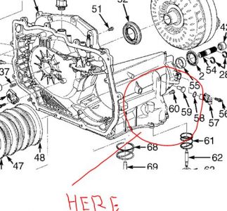

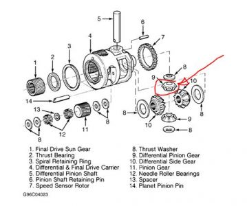

https://images.2carpros.com/forum/automotive_pictures/61395_trans_6.jpg
https://images.2carpros.com/forum/automotive_pictures/61395_diff_gear_1.jpg
Lower pic is the diff carrier and the broken gear, top pic is the trans case, if the case is broken, it will be unrepairable. Mark (mhpautos)

Those pictures really help. You guys are awesome! I'll definitely recommend people to this website. I don't understand why it is unrepairable though. Is it because it is a one piece case? I cant buy a new casing for the transmission?

As price of a new case, re building your transmission and the removal & re fit may exceed the price of a re-co transmission, but this is up to you, i would be pricing both before making any decision.
