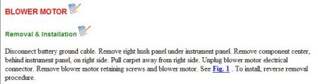

Replace blower motor
Wednesday, June 24th, 2009 AT 5:56 PM
BLUELIGHTNIN6
MECHANIC
16,542 POSTS
FIGURE 1
