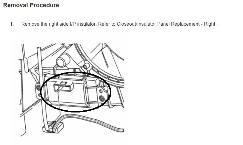

Looking for image's of location for HVAC blower resister and blower control module.

You need to get up under right side of dash. I know it is a pain, I am an old man and I do not like working under dashes, either. I posted the diagram so you could see wiring colors at the connector for blower motor control processor/module. Just make sure module is the problem and not something else, like voltage and ground. Hope this helps.
